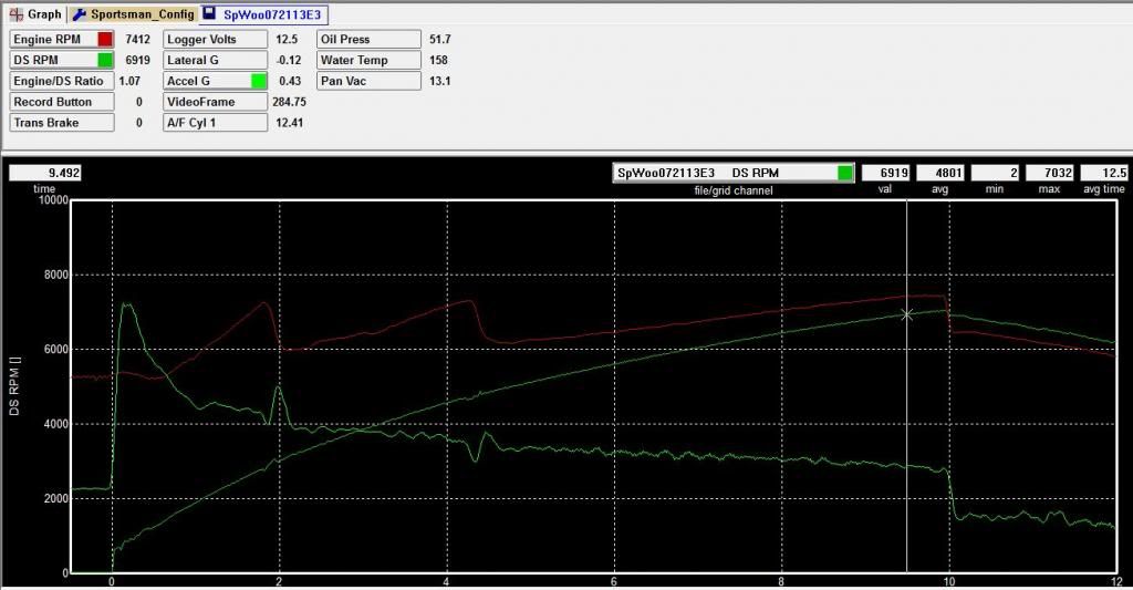

DS @ .250 = 901 RPM
DS @ .500 = 1,230 RPM
IC is 40" out 8" up...I have been everywhere with it. This has been the quickest so far and not killing the tire as hard as it has. This chassis has been hard to get right with the low amount of power the motor is making. It has cheap single adjustable strange shocks on it now...
I may have went about the 4 link changes differently in the beginning if I would have had video to go with the racepak data...

The problem is it seems to be inconsistent which make the car hard to dial. I thought I had it hooking good by looking at the racepak graphs, but after seeing the video it looks as if there is more to be desired...
