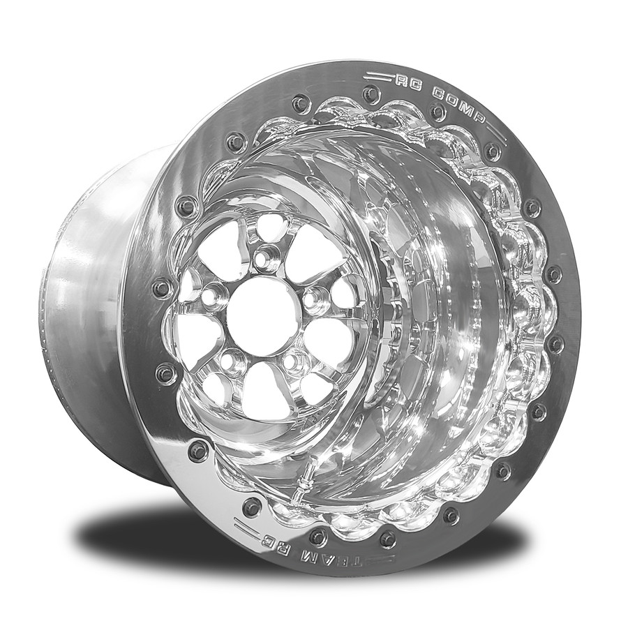

Anybody here using racestar double beadlocks or their wheels in general and your opinions. I was close to pulling the trigger on a set of weld Deltas, then I saw a brand new RJ mustang for Cuadra and on the rear are race star wheels! $4200/ wheel vs $1700. I know you get what you pay for but in pro stock where everything counts, those wheels aren't on there if theres anything compromised.
Also, RC Components make a similiar beadlock but is $3k. I think I like this wheel style the best but just keep going back to the race star bang/ buck. These are all comparable 1 piece forged double beadlocks. Any opinions....

RC Components:

These 3 wheels are 1 piece design unlike other beadlocks. I have a set of converted 16" Bogarts on the car right now and my Vette has weld 15" doubles. These manufacturers I listed are the only ones making the 1 piece right now, I believe they are fusion welded. Lighter and there was a thread on here stating there are other advantages to this design. I do believe it will help with tire shake issues as its not for the car in my signature but a comp elim car, 205+ mph.
And its not counting pennies, hard to justify spending almost 3x the amount when the cheaper wheel is being used in max effort classes by the best. Greg Anderson is also using Race Stars last year and as for Elite, I do believe Cuadra is elite and I know RJ works with them so.... As for not buying chinese products, GOOD LUCK with that, even at the grocery store! I shopped some years back for shoes made in the USA and ended up settling on assembled here, as the products made here were repulsively ugly. Dont know if that changed recently as if I only bought USA, none of us would be on our computers on here. Not ready to give in on the race car yet, will probably either look for a set of used Deltas with the right bolt pattern and backspace from a pro team switching to race stars (elite has a bunch for sale) or buy the RC wheels. Right now RC has on their site they are just taking orders now, not in production yet. Hard to justify $4200/ wheel. And yes I've wsted, err spent..., stupid $ on alot of shit for the race car. Getting older you have more $, but seem to get more frugal. Damn Sucks LMAO!!

Ordered the RC Component wheels. I just couldn't stomach putting chinese wheels on the car regardless who runs them. They said 10 weeks out. They will start filling orders and theres about 20 orders in front of me. The price will go up when production starts and thats why I'm doing this now. If they get held up on production I can race the double bogarts on the car now.

They’re fusion welded in China. That’s fine if you keep an eye on them just like all the rest. It is important to note where the wheel is welded. You can’t see it because of the machining. People tend to watch the bead ring and centers. The middle of the barrel is out of the ordinary and would be your new priority spot. They run them because I sold them to them. I would have sold them Welds if I had still been there instead. RC Components are the best made wheel on the market in my opinion. I didn’t work for them though.
