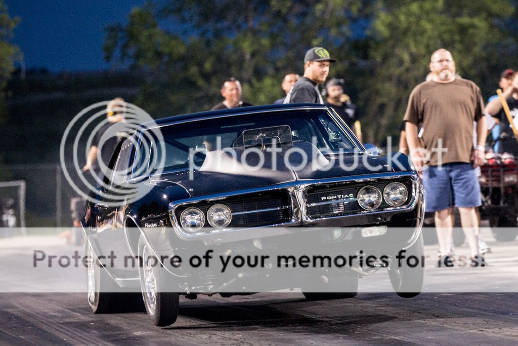

Hey guys thanks for the posts about our scoops. We have been fabricating and selling a lot of these lately. We appreciate some of you guys posting about our scoops. Anyone looking to have one made can contact me on here via PM, call at 813-447-7026, visit our Facebook or website in my signature.
We build custom scoops and also have a standard size we keep in stock. We can do them in clear, smoked or painted colors. We also do custom Lexan airpans as well for those wanting to keep thier cowl hood and find some more power.We have seen gains of 2-3 MPH in NA combos and 1-1.5 MPH in NOS combos. As with any type of combo there are many variables that determine how much each engine will pick up.
Here is a few examples of our work!
