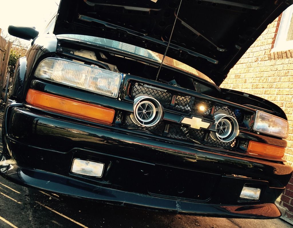

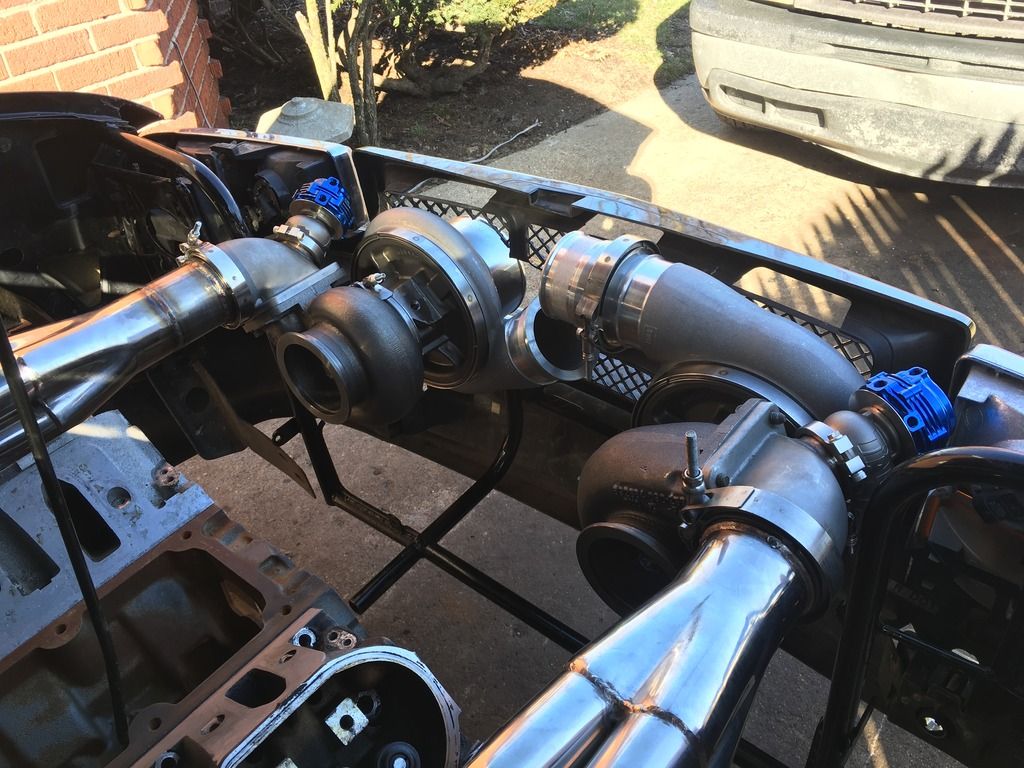

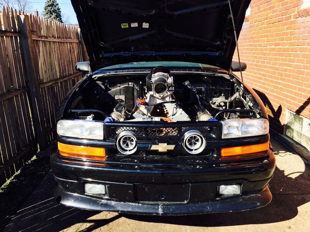

I pulled the trigger on one of these 417 Motorsports 2000hp Intercoolers last week.. gonna run a stock hood and just let it all hang out!:p curious to see how the intercooler performs, I have a rule 3700 inside a 12 gallon Ice tank. finally got both turbos mocked up. not bad for being driveway built lol
