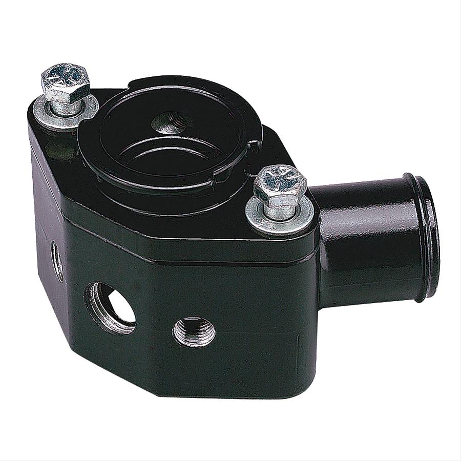

Remote rad cap at the highest point would be step 1. Even with the rad full, you will still have an air pocket in the high point, which will be pushed into the rad under acceleration, which will open the cap and let out water with the boiling air.
I had similar problem, pushing water out. And kind of the same setup. Pressure tested system, ok. So I drilled and tapped the top of the t stat housing and installed a petcock . Opened pet cock and turned pump on. Bled air out of system for 15 or so minutes. Haven't added water since. Been almost a year. Good luck Cory

Older corvettes have a remote rad cap look at that system for ideas.
