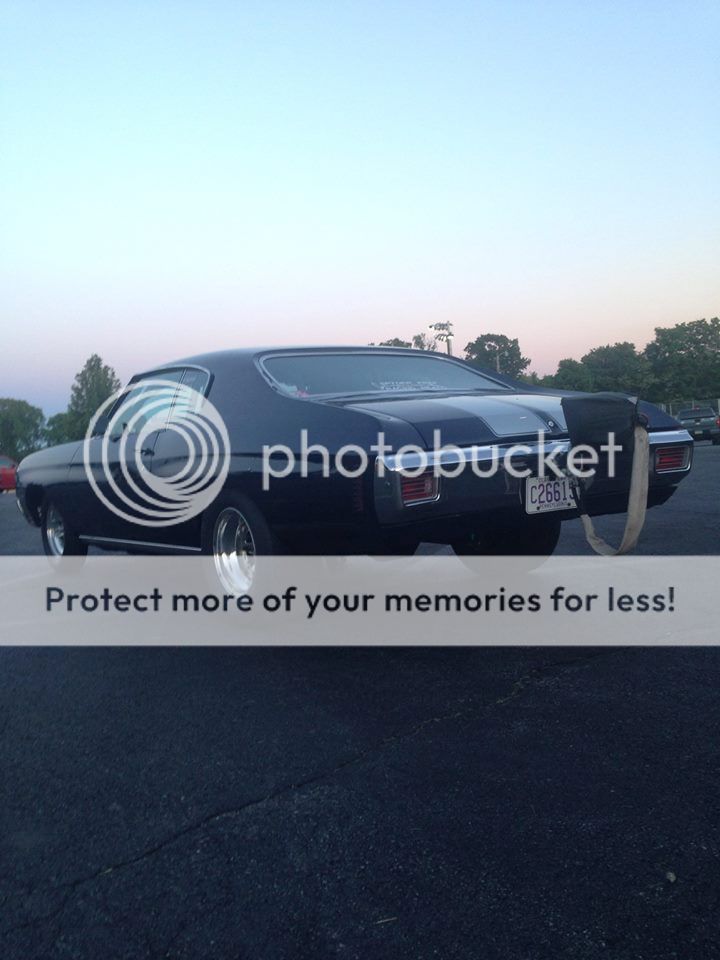

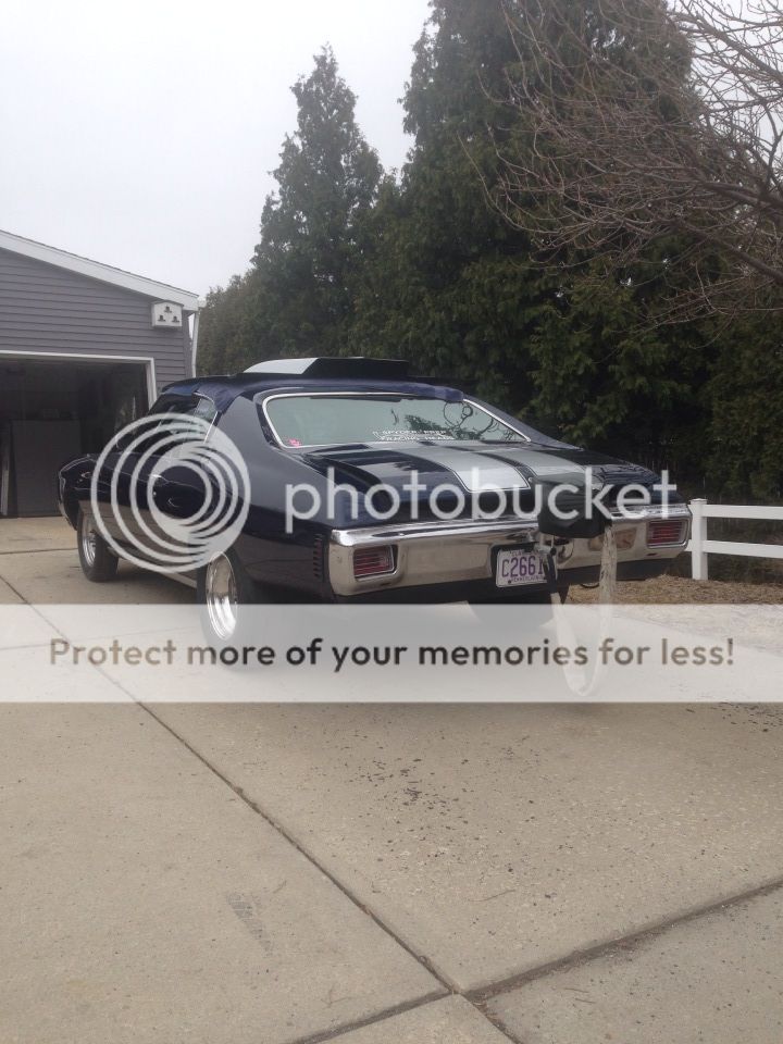

#19 · (Edited)
275 Pro's on 10's on my Streetcar. Leaves on 12# boost 20# by 20' which is around 1100 to 1400 by 60' in car that weighs nearly 3800# 8.43:1 starting line ratio which is retarded for that power. No hi-tac, no bead locks slips the tires on the rims 4" average every pass. I'm going to try more boost, less SLR by leaving in 2nd and beadlocks to knock the 60' down into the low 1.20' from the current 1.28.
