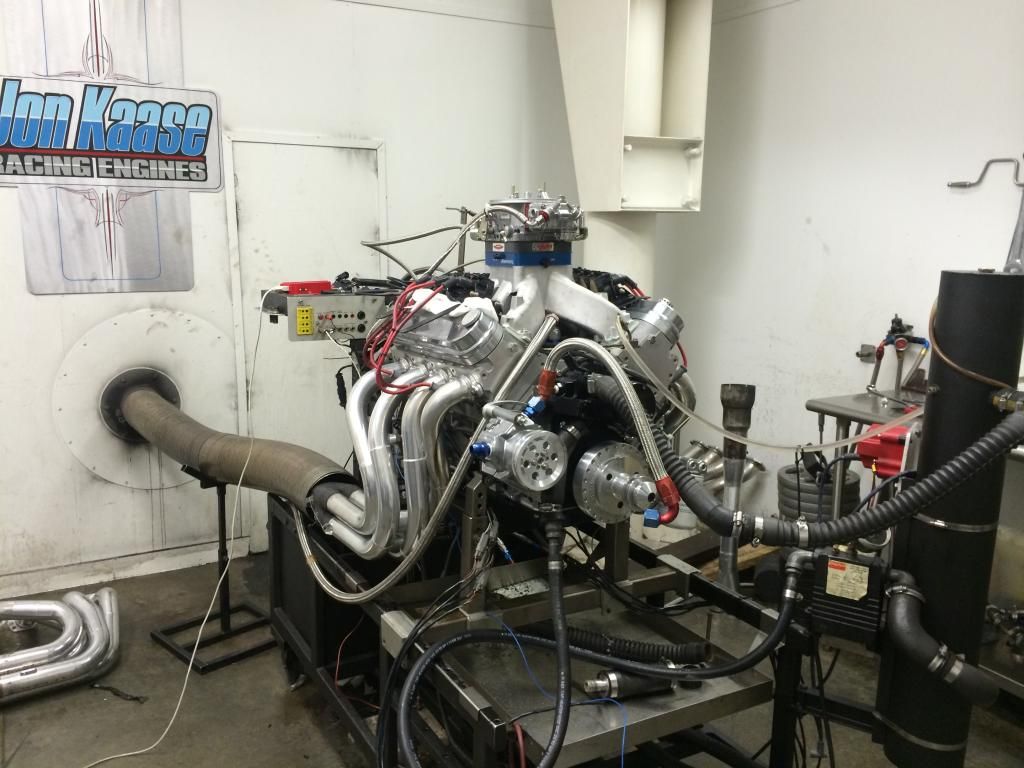

Example of your thought.... This guy brought my Dumb ass A long Way...
