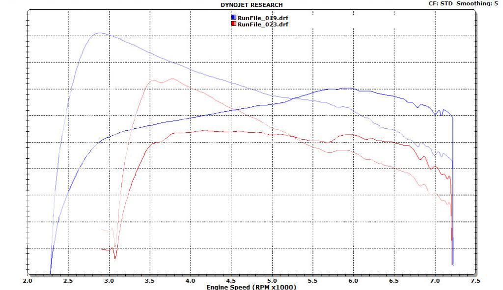

I shift mine at 6500.
Blue line is more boost and race gas.
