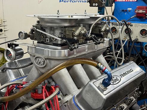

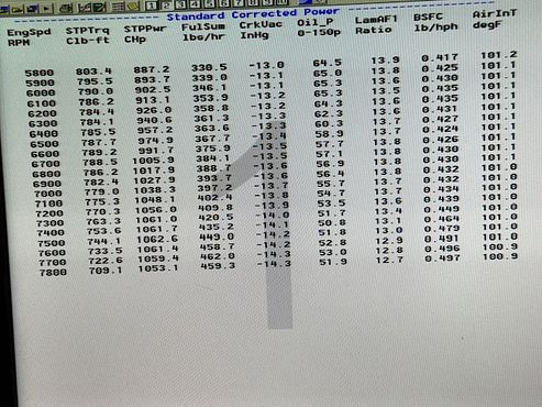

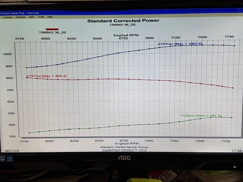

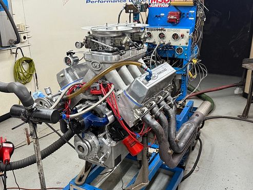

my little project - It's my porn: 565" Ford 12.65:1 compression. Cammed for a boat with wet headers:
3 weeks before it was on another dyno and lost 20 lbs ft at 7,000 (26.6 hp). It wasn't eating itself so we finished the dyno session. Got it home and checked a few things out, and thought we had gained some of it back. After the third pull I realized we hadn't. A part of the problem was, come to find out it had some bad leakdowns in half the clys. So, there is more in there to be had. Needs a good freshen-up this winter.
