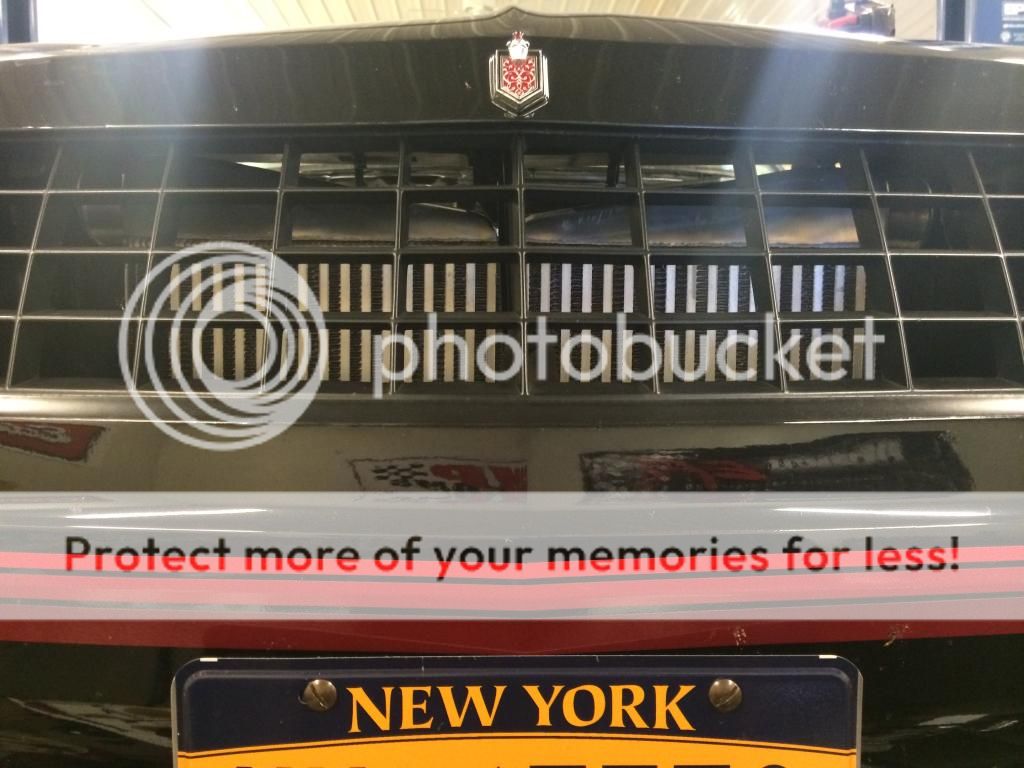

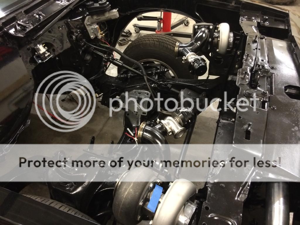

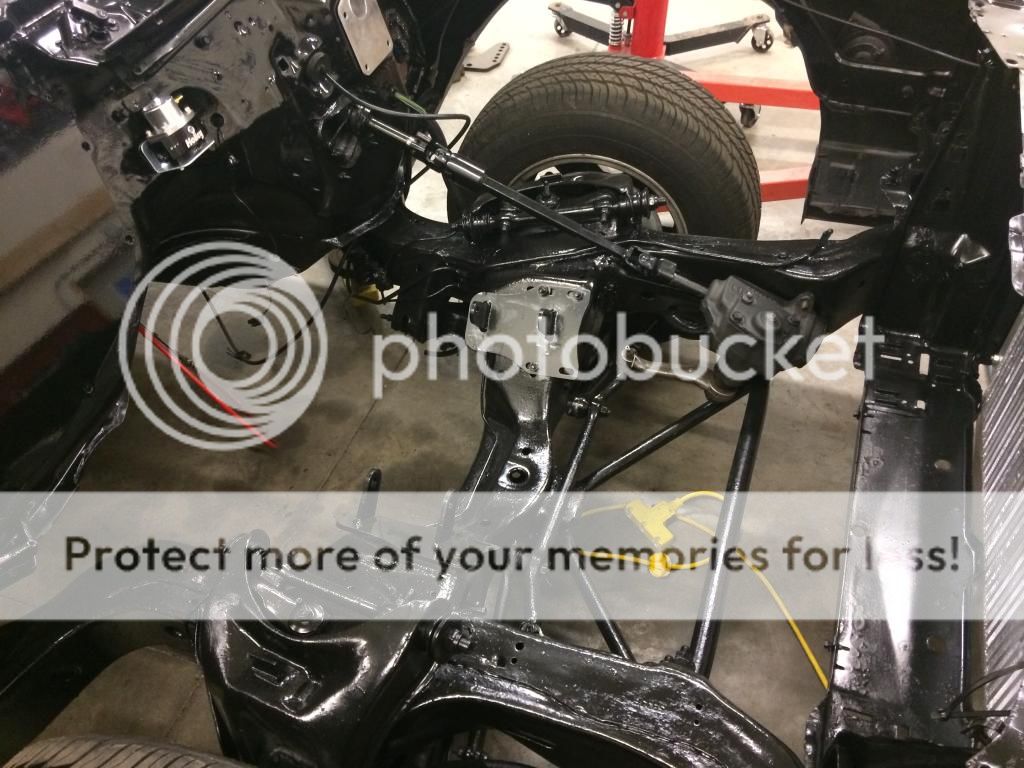

Spent a lot of time working on the car this weekend, but not a lot to show for it. Its been a endless cycle of welding cleaning and painting all the brackets that i made or tacked together.
The intercooler is finish welded and in the car, steering box is in for good along with the original pitman arm from the power box and the cherokee intermediate shaft. fuel pressure regulator is mounted. Ive been going back and forth between working on the manual brake conversion/linelock mounting, and then fiddling in the trunk trying to find a good place for the battery box. It looks like i'll have to build a little subframe that sits down in the spare tire well. If anybody has pictures using the summit box (which seems bigger than it needs to be) i'd love to see them.

What size intercooler did you end up using?
http://www.ebay.com/itm/251621226074?_trksid=p2059210.m2749.l2649&ssPageName=STRK:MEBIDX:IT
CX Racing
Core Size: 24"x13"x3.5"
Overall Height: 20.5"
Two 2.5" Inlets, One 3" Center Outlet

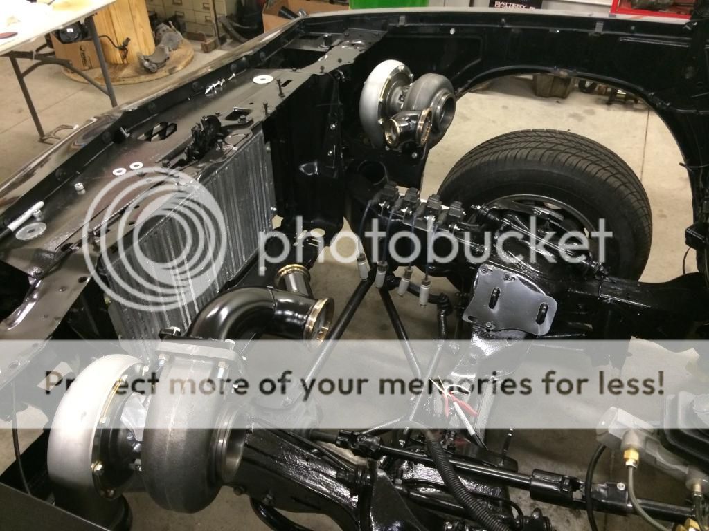

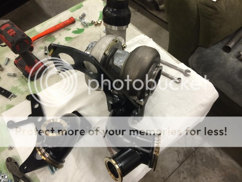

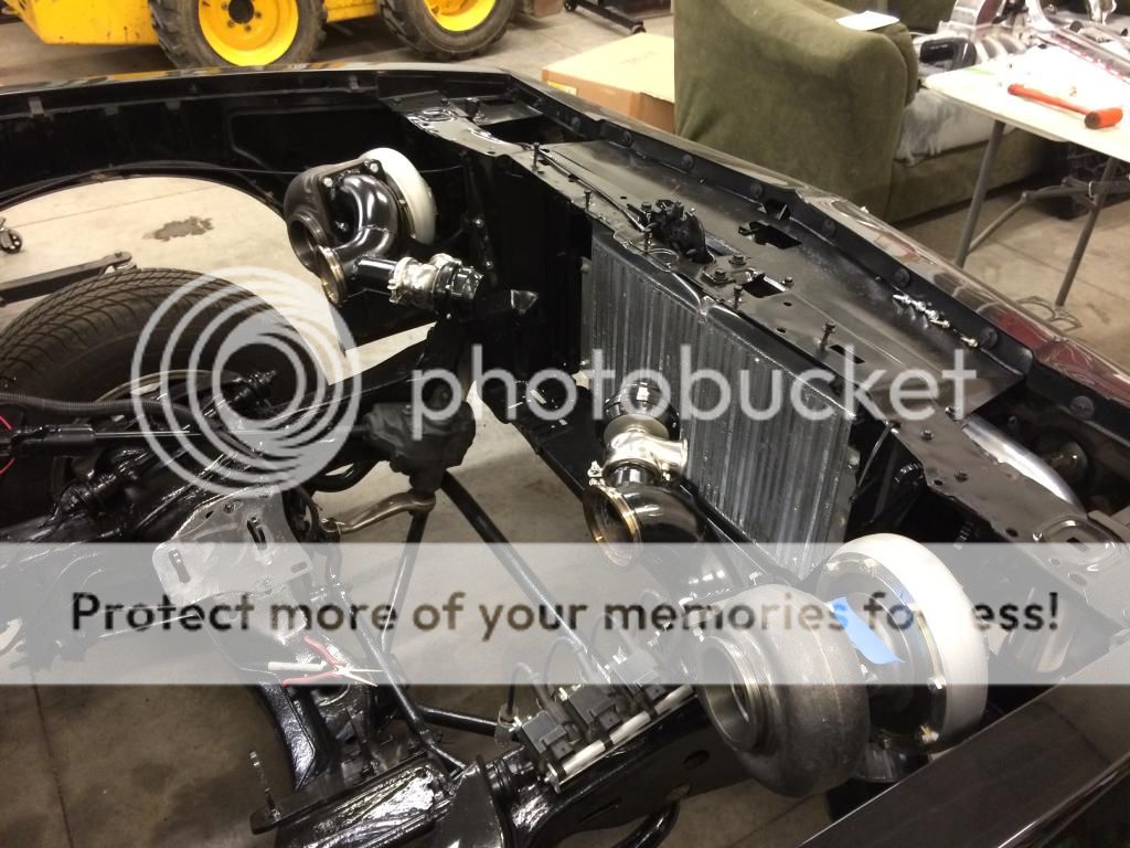

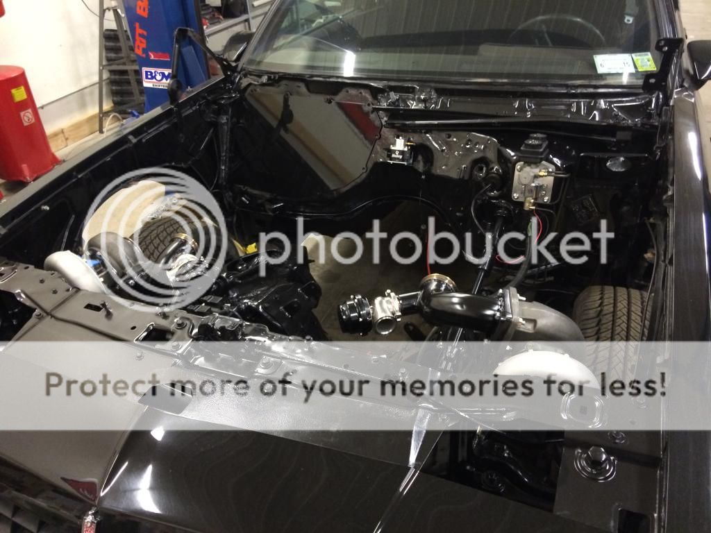

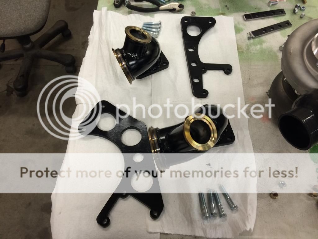

Sunday and yesterday I was amble to get the passenger side turbo clocked correctly to get the feed on top and the drain on the bottom. The Holley 302-1 pan showed up. Nice piece. I almost feel bad about drilling holes in it for drain bungs. The pipes from the headers to the turbos got finish welded and painted, and the turbos are hung in the car permanently with gaskets. The wastegates aren't perfectly symmetrical when looking at the front of the car, but I would prefer to have it easy to work on rather than fight myself all the time. Plus when the hood is closed you will never know haha. I'm really at the point where im waiting on the engine to come back so i can finalize a few things like coil mounting. Im thinking they will be mounted on the top of the frame on either side, and plug wires will run along the block and come up from underneath.
