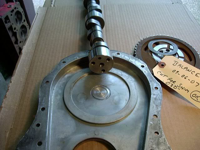

P.S. Here's a shot of why I say don't line up the pin and the "designated" hole, if the pin ever decides to "leave", covering it with the lock plate will help keep it in place like a retainer.
