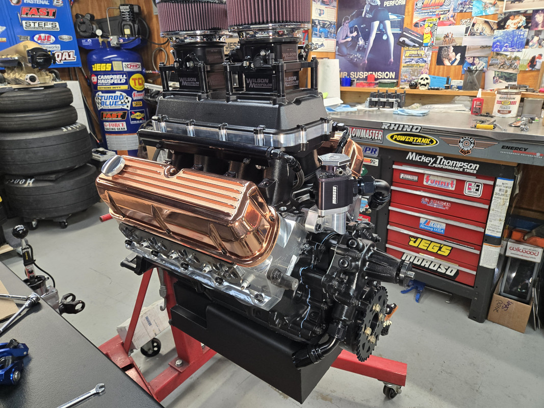

#23 · (Edited)
Is this your intake?: If so, I think that motor of yours is going to make plenty of grunt, and rev pretty good on top....Looking forward to seeing dyno and in-car results on this one!
Yes that is mine, done by Chopper Scott. I will have it soon!
