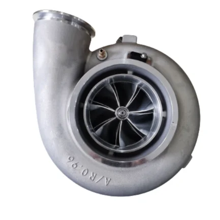

Do these specs check out? In theory how much would this turbo support?

Its damn sure cheap enough. If the design of the turbine and compressor wheels is really good the sizes selected should be capable of 1800 - 2000hp on the right engine combo. An actual compressor and turbine map would tell you what they are really capable of making. Looking at wheel sizes never tells the whole story. LBS/MIN of air moved at what pressure ratio and efficiency is what you really need to see.

Idk if that will do big numbers tho, depends on the combo. Def will prefer small cube deals. That seems like they squeezed a s500 turbine wheel in a s400 frame. My friend used the s500-88 and had it upgraded to a 94 i think and it was basically pegged over 2:1 backpressure and done around 1400 whp range on a 414 lsx if I remember it right. I know it was in the 1300’s whp with high back pressure but a few psi short of what we seen at the track.
So that 92 may have decent flow to get up into the 1500 whp range but thats asking alot out of a s400 frame. Im not sure what the limits has been. The biggest true s400 i know is the FI 94 mm with the 104mm turbine. Its been pretty quick on single cars in the 1/8. 4.46 at 160

Thats not how it works. It likely would max out even sooner than the small cubes
As said, if thats the vs racing 92/110 its a poor flowing turbo. It doesnt make the numbers you would think

1300 -1400 whp. We used the s500 before in 88 and 94 mm upgrades and thats about all it had on a 414 lsx. 572” will choke that turbine plus that turbo is very big and heavy for what it is.
Your only option is finding a precision 98-118 g trim or a garrett like mentioned. The newer smaller turbine seems to spool quicker and be fine with high flow like the older g trim stuff
