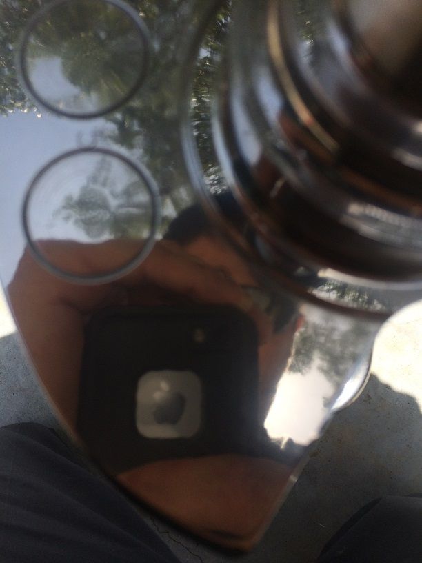

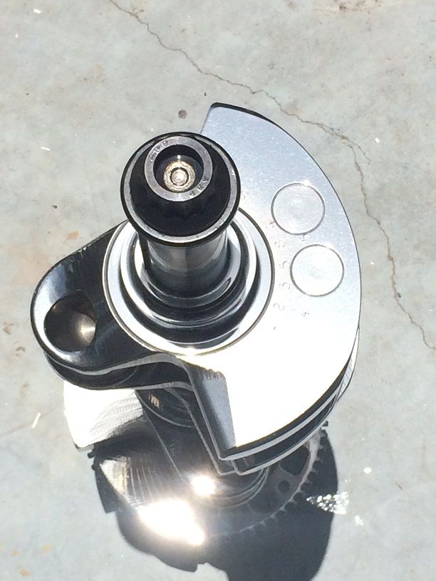

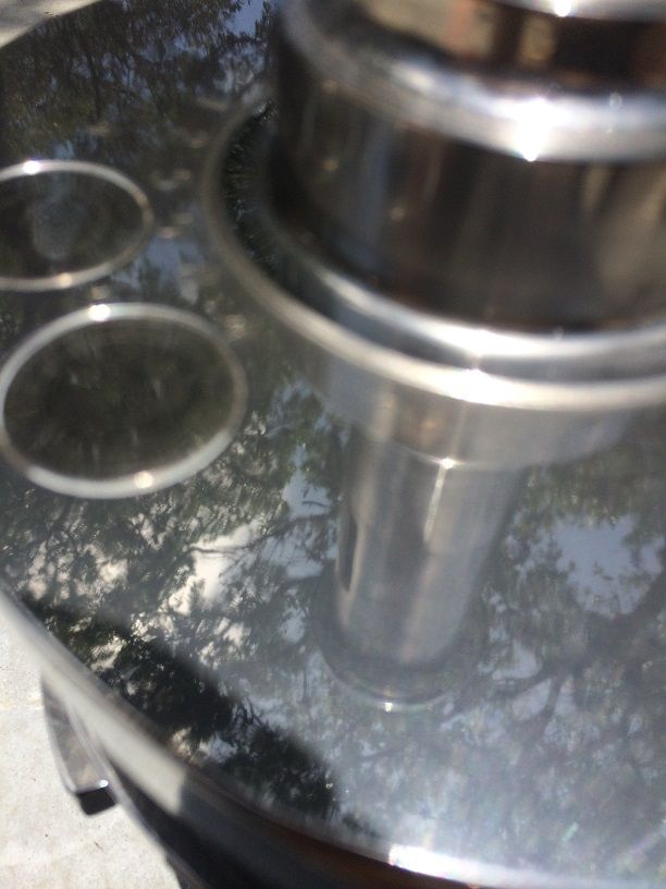

That's about all I can think to post for now. Here's some pictures of the rods, crank and a mockup of parts.

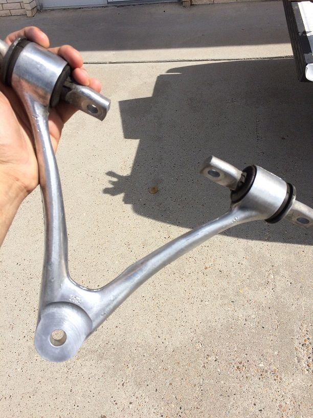

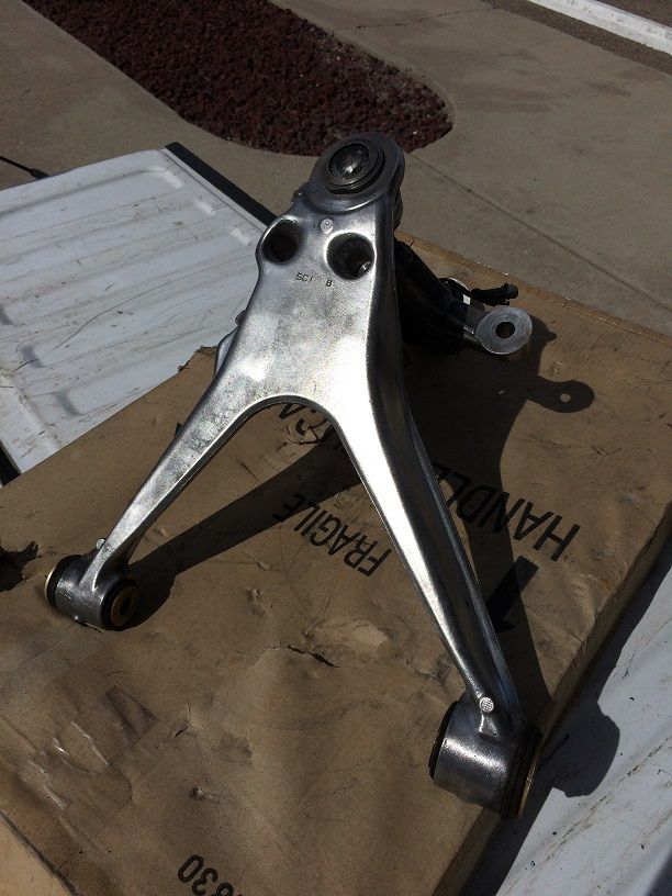

In the meantime I've got a bunch of small things planned. I'm cleaning and painting all the suspension cause I hate dirty corrosion, and I'll also be correcting the paint thanks to my background in paint and body work.
Here's a few pictures for your viewing pleasure

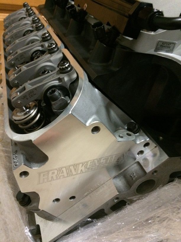

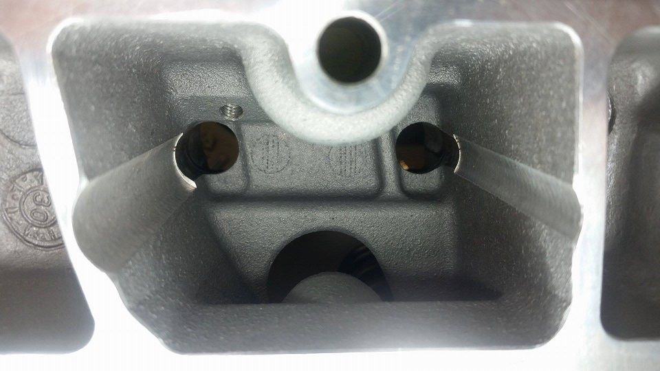

Small update. Frankenstein is finally done with everything, so I'm over here like
Heads, ported FAST 102mm and Crowers should be here early next week. All that is left to get are headers, pushrods, timing chain and lifters.
Heres' a few teaser shots of the head work FRH sent to me.
I'll get more pictures of everything once it all arrives.

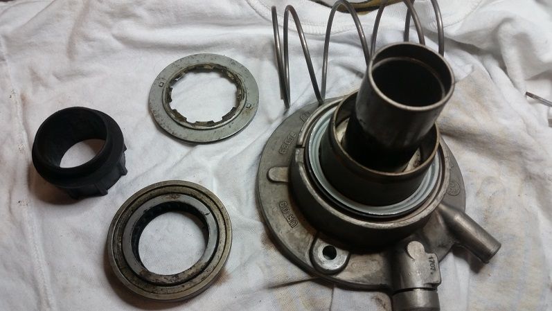

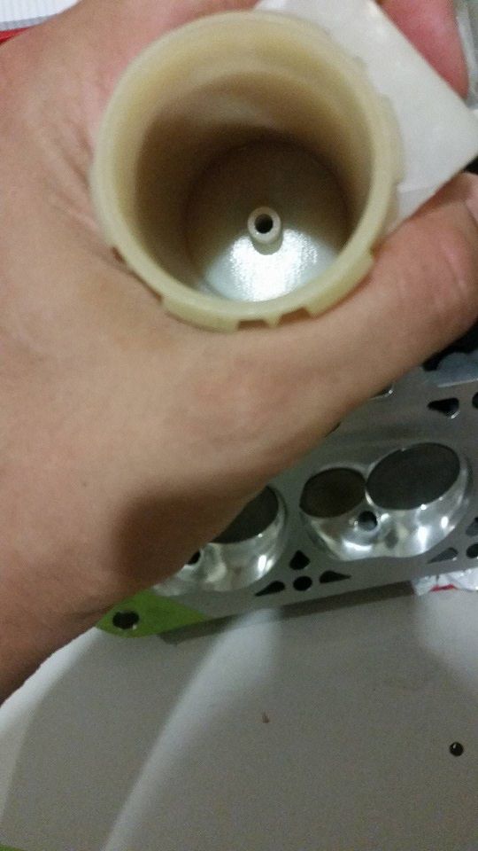

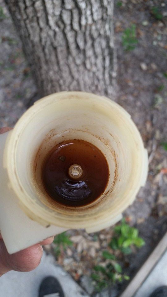

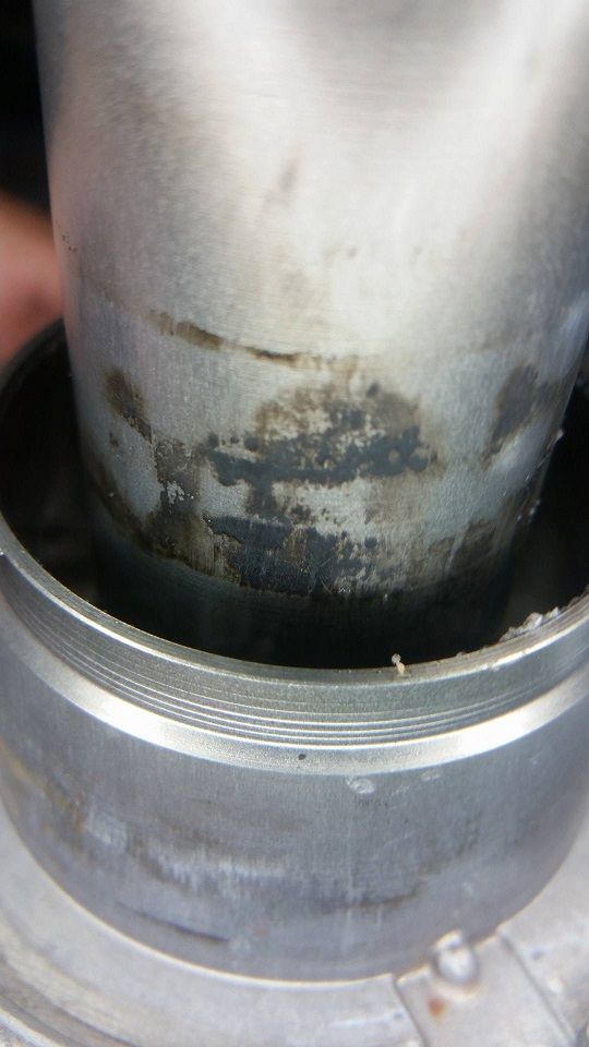

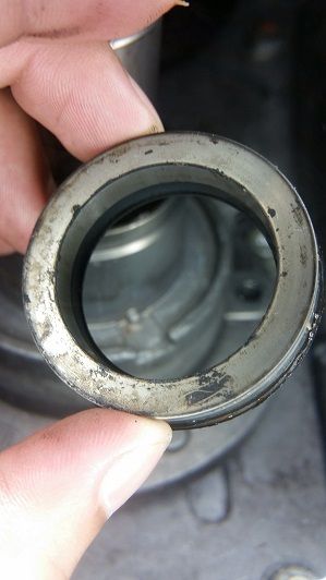

Got all my clutch measurements while everything is blown apart also. Everything is golden there as well. I completely disassembled the slave to thoroughly clean it as it been 40k miles with the stock fluid. Yuk. I'll be replacing that shitty little plastic bearing support with Monsters billet piece.

I've finished up all the small tasks finally. The motor is jus about ready to be dropped in. Only thing I need is cover gaskets, billet tob support and the C7R chain.
Clutch / slave measurements are good. Right at .100 or so. I also cleaned and flushed the 40k mile nasty fluid out of the master, slave and lines. This should help minimize any potential issues there.

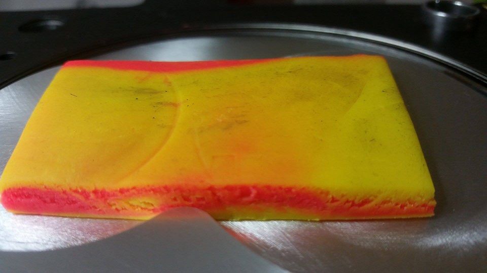

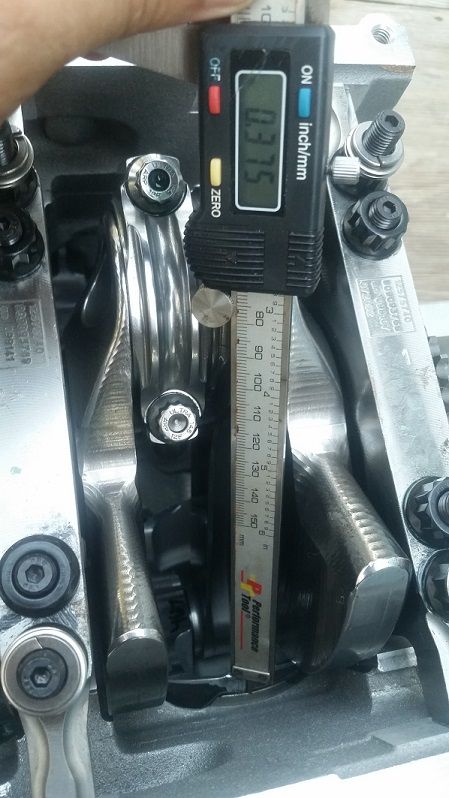

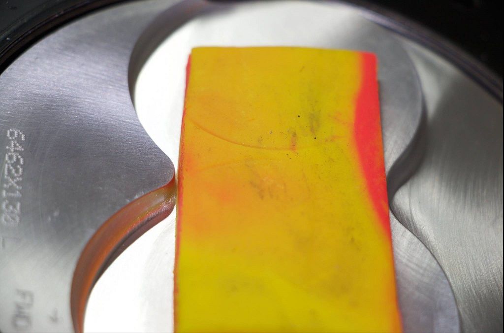

Next was p/v. I have clearance for days there. It was somewhere .240+ for both. The piston only stick out .375 at bdc.
Clearanced the pushrod holes so I can run 7/16 columns from Manton. Pretty sure I'd have room for 1/2 rods, but that won't be necessary.
Here's some before and afters. Just have to tidy them up a little more.

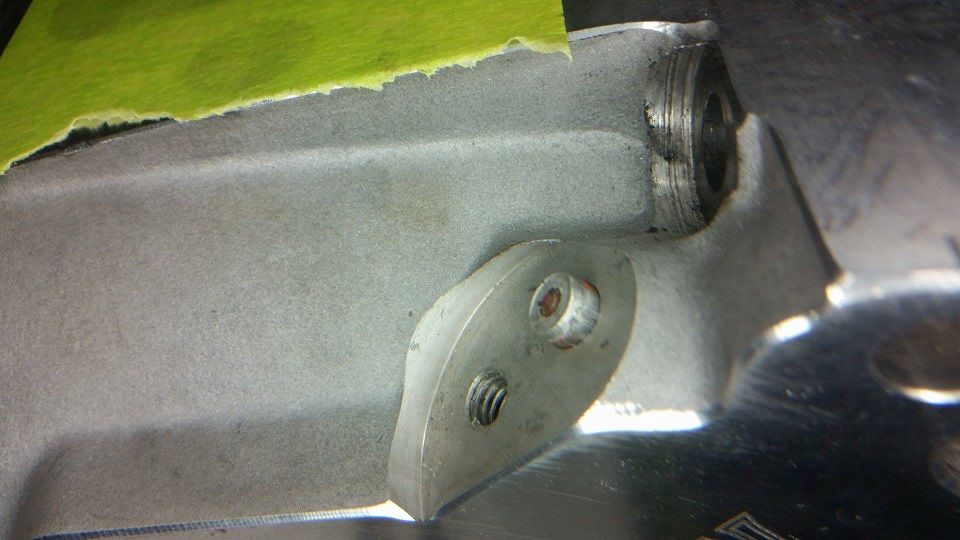

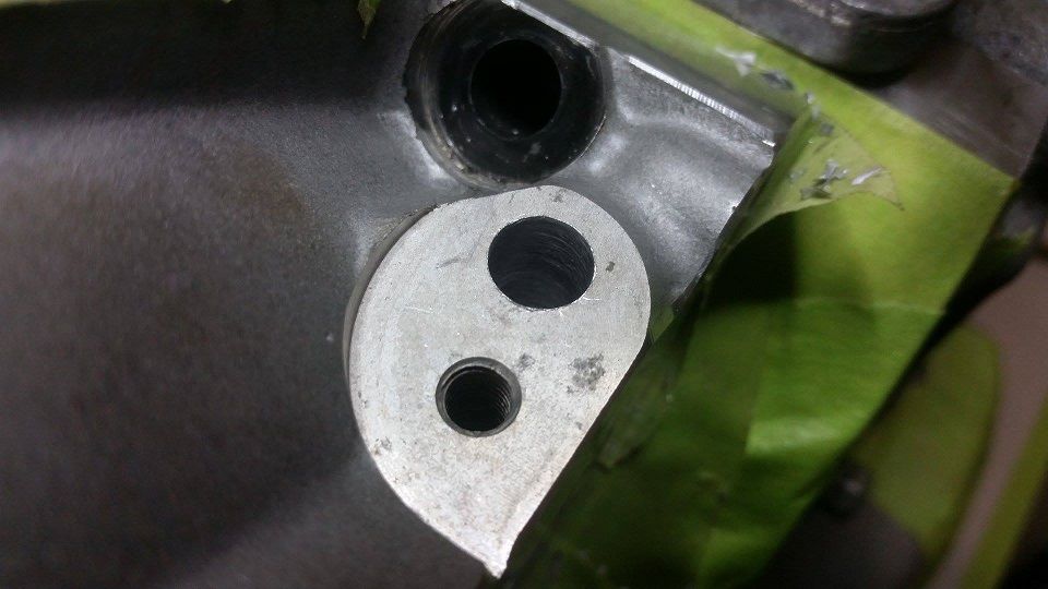

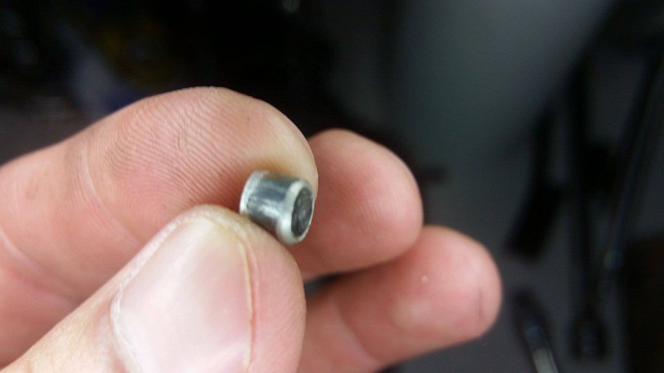

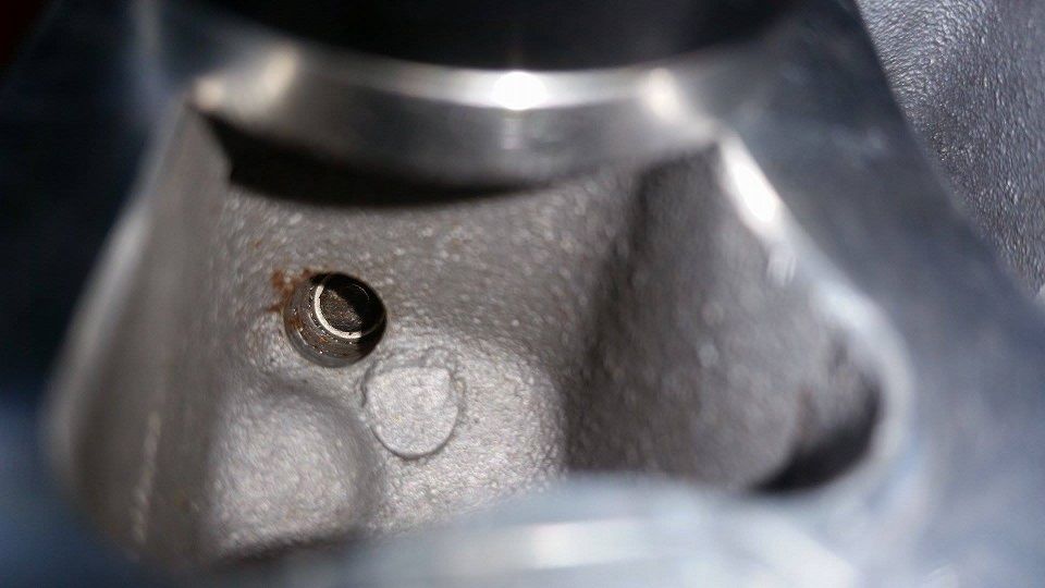

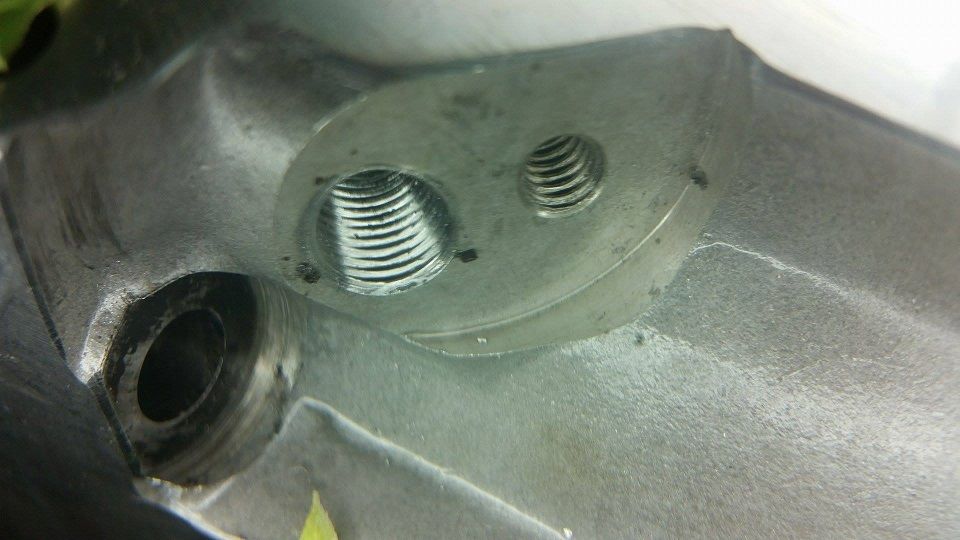

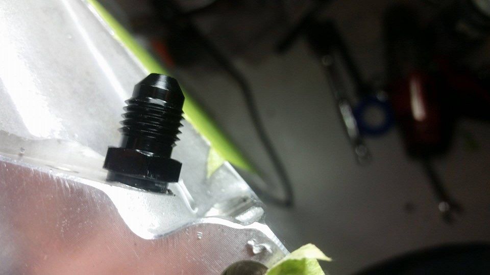

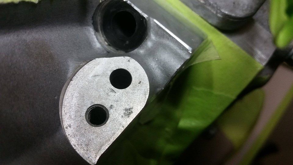

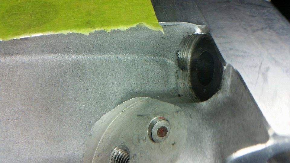

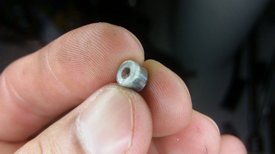

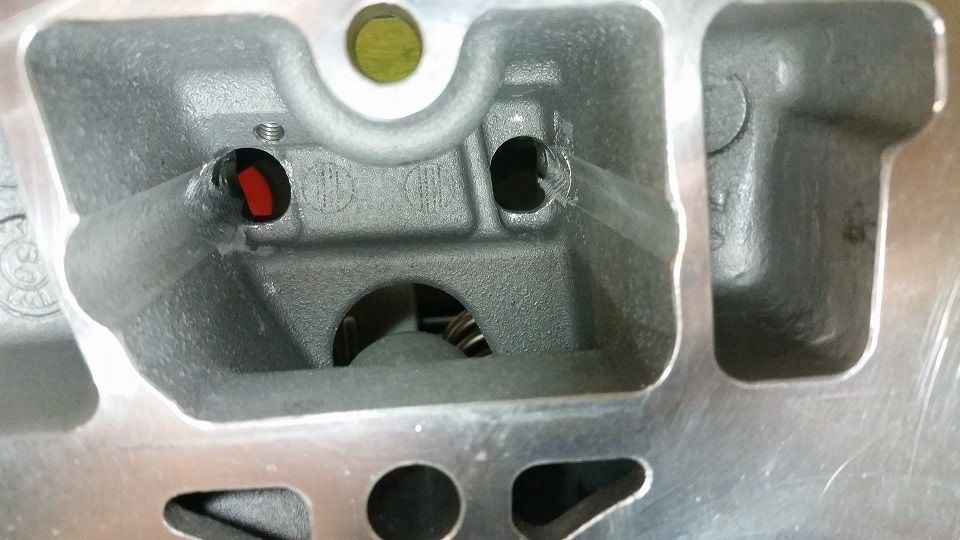

Here's something I found very interesting. The rear steam ports on the LS7 heads are actually riveted closed. When I was getting ready to drill the port out I noticed they looked plugged up. Took a small punch to the under side of the head and knocked the plugs out. Drilled and tapped them for -4.

Put the base of the intake on the long block.
Make sure the roof of the intake port doesn't droop into the path of the intake manifold.
The exhaust gaskets might need a little trimming so it doesn't block the very bottom of the exhaust port.
I've done some pretty extensive port work to the FAST intake and made fantastic gains.
PM me if you're interested in any details.
