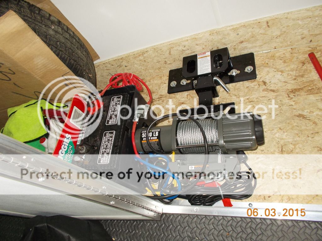

#10 ·
Mounted my winch to a trailer coupler. I use my winch in the garage, in the cenclosed trailer, and for my gooseneck open trailer, and all I have to do is pick it up and take it with me, put it over a 2"ball and it's tugging. Can be used to pull a drunk ******* of of a mud hole also.
A 2inch ball doesn't take up much space. Actually it's just 2 inches to be exact.

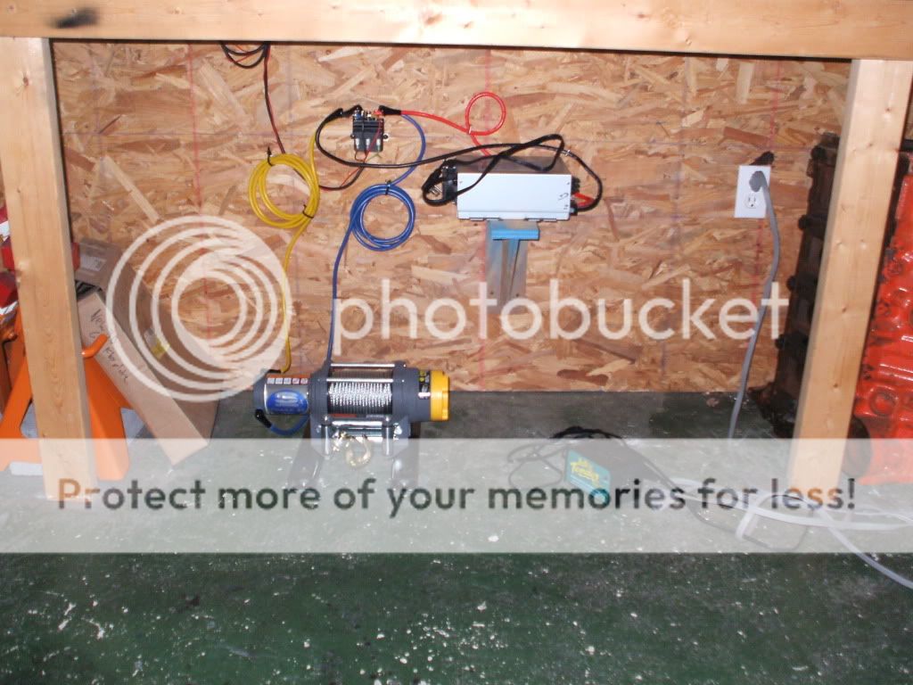

#13 ·
I used 1" X2" bar stock,and mounted my winch to the floor.Its uphill into my garage.I had a helluva time getting it in when I broke it.
I had to buy an inverter,to run the 12 volt winch off of house electric.
