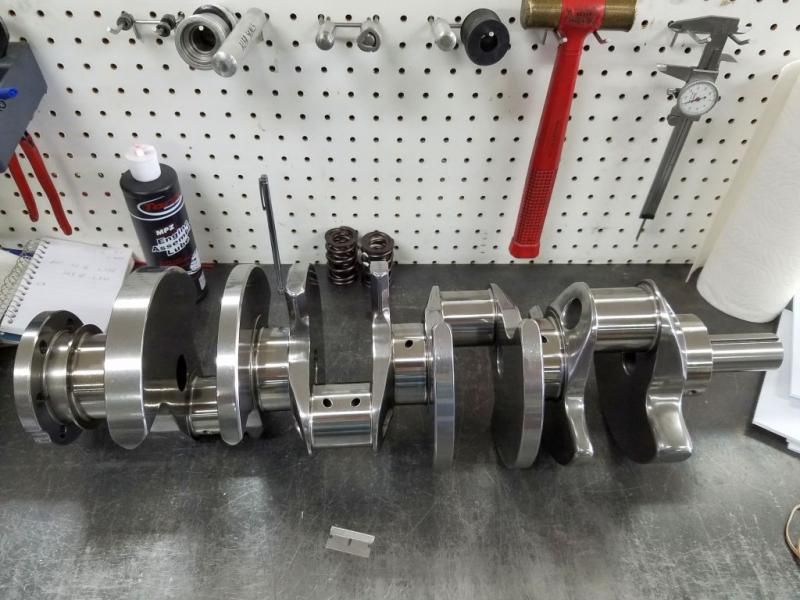

Dont leave us hanging bro, pics...
My cnc guy said 300m is basically a super pure form of 4340, a nifty thing is it doesnt warp when heat treating like 4340 does.
Came 2 or 3 weeks ago. Bryant billet. High speed oiling, fully counterweighted, knife edged and REM polished. Easily the nicest crank I have ever bought.
4.125" stroke. Going in a 468-470ci Pontiac twin turbo.
