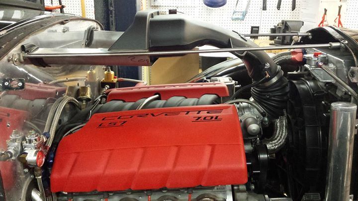

https://cimg9.ibsrv.net/gimg/www.co...671838425083_5822264320137356424_o_91e97826f343967383e1a5334d02553b6a469040.jpg
Guys here is a pictures of my setup now. As you can see. I had to work with the space I have. I run a high flow air filter, and draw air off the windshield. And I made a custom cowl hood to help.
That's pretty unique. I like the "outside the box" thinking that went into it.
C5 Pete what kind of RPM with your different setups?
Fast intake shifted at 6800. Hi Ram shifted at 7800.
