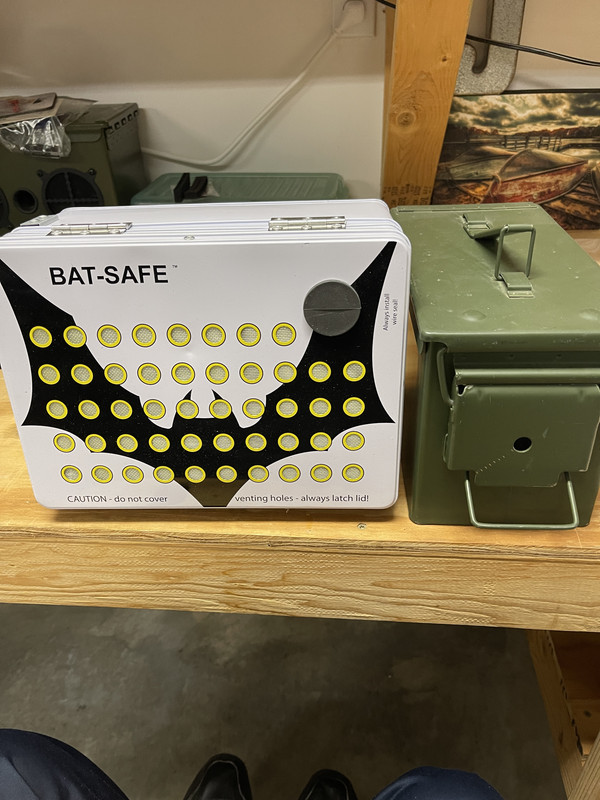

I have 25 years experience with lithium batteries in big RC helicopters and airplanes and I wouldn’t have it in the drivers compartment without at least having a heat shield. I definitely wouldn’t put it in a sealed compartment. I have seen them turn a sealed ammo box into a bomb. When storing mine I put it in a vented metal box. I’ll show a picture below.
When they go up they burn extremely hot so you don’t need a flame touching you to get burned very badly. Once they get damaged they can easily short and catch on fire. A buddy of mine crashed his Heli and when we left he got out in front of me and after about 5 minutes I start seeing a little smoke from his trunk.
Before I could text him he pulled over and he didn’t even get the trunk open before the car was engulfed and was a total loss in an incredibly short amount of time.
Keep in mind your current fire suppression system isn’t going to do shit for a lithium fire and the smoke is extremely toxic.
I put an ammo can next to it for a size comparison.
