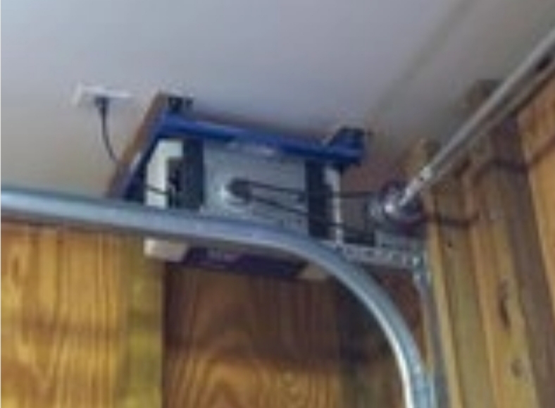

Have any of you set up something that works off the end of the spring shaft?

I have an Overhead Door unit on my 10 footer.
I know it's for a regular size because when it's all the way up about a foot of the door still shows.
If you're good with that like I am they work just fine. If not, you're going to spend the big bucks on a commercial opener.

Watched a couple of you tube vids...one. a guy took normal opener.. turned sideways. Took the timing chain set off a Ford soaking. Used both sprockets and chain. Lol it worked..
