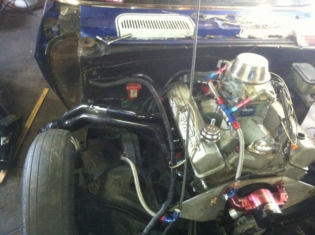

OP I built a set of fender exits for my car over the winter..... They are 1 3/4 stepped to 1 7/8 with 3.5 inch collectors with mufflers on them. I built them to gain ground clearence as my car is real low but they seem to hurt low end power a little...... That being said mine is only 355 inches and around 590-600 HP..... They might work better on yours pm me if your interested in them.

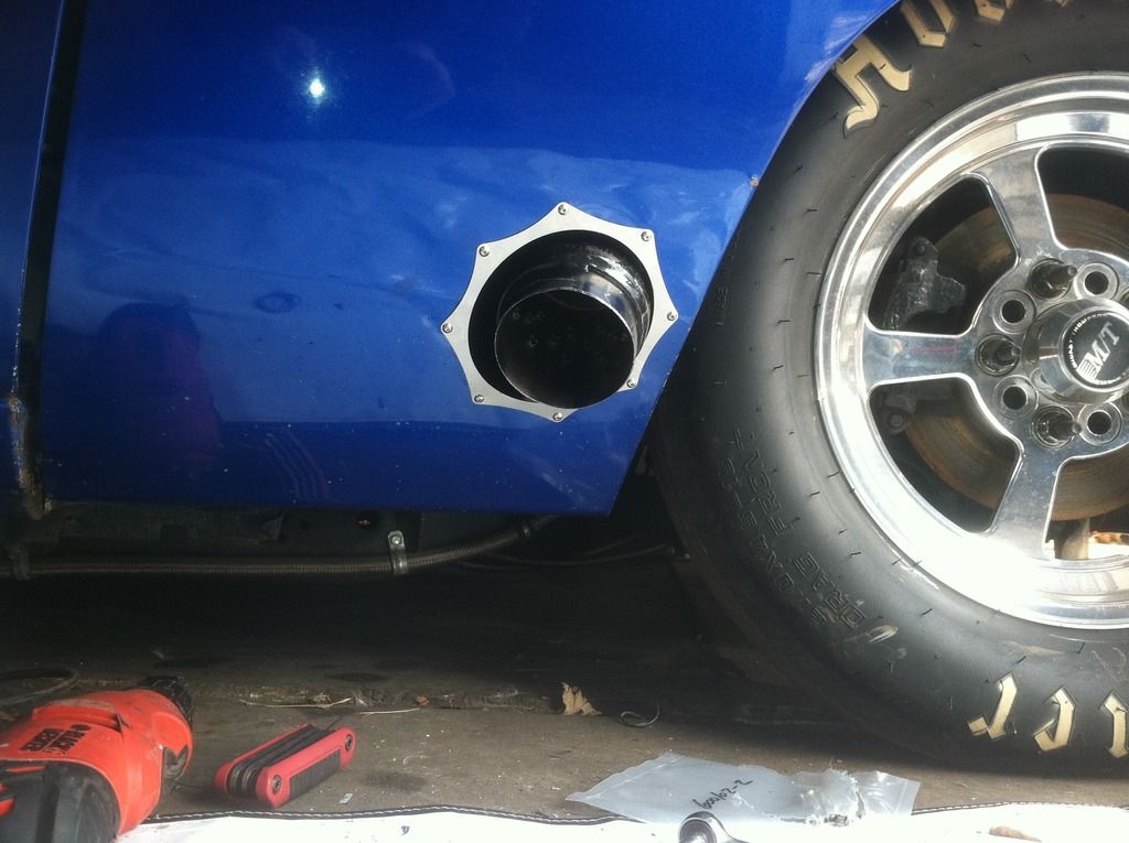

have a friend that just had a set made for a 69 nova,bigblock.you have to notch the corner of the firewall box to center the collector in the fender.he loves them.his car is stock front subframe-but has a midplate installed on it.so headers where a bitch under the car.plenty of room this way. the above picture shows the collector not centered and that is why you notch it back.
