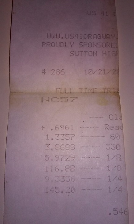

Made 600+ on a with an eagle cast crank and SIR rod 383 Sbc with two T04B turbos. Had a 4300lb truck into the 10’s back in 2006. Never had an issue and that engine I sold to a buddy and he still has it. Last dyno’d 500hp 535tq with a small weiand blower on it now. Not ideal by far but was cheap and it held up well.
