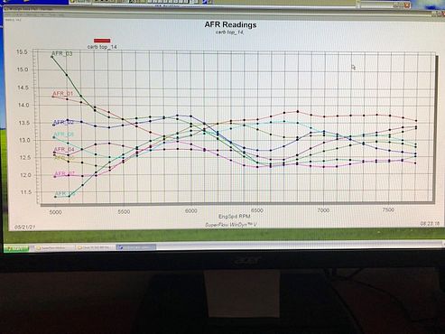

There's a lot of stagger in this fuel curve for the 565. A lot. It did not like square jetting one bit. I'll see if I can locate the out of the box square jetting chart.PS: there is something to be said for at least having 8 egts, and an 02 in each collector, if not having 8 02.
There would be gains to be found in staggered jetting. Steve at Westech had shown this a few times over the years.
