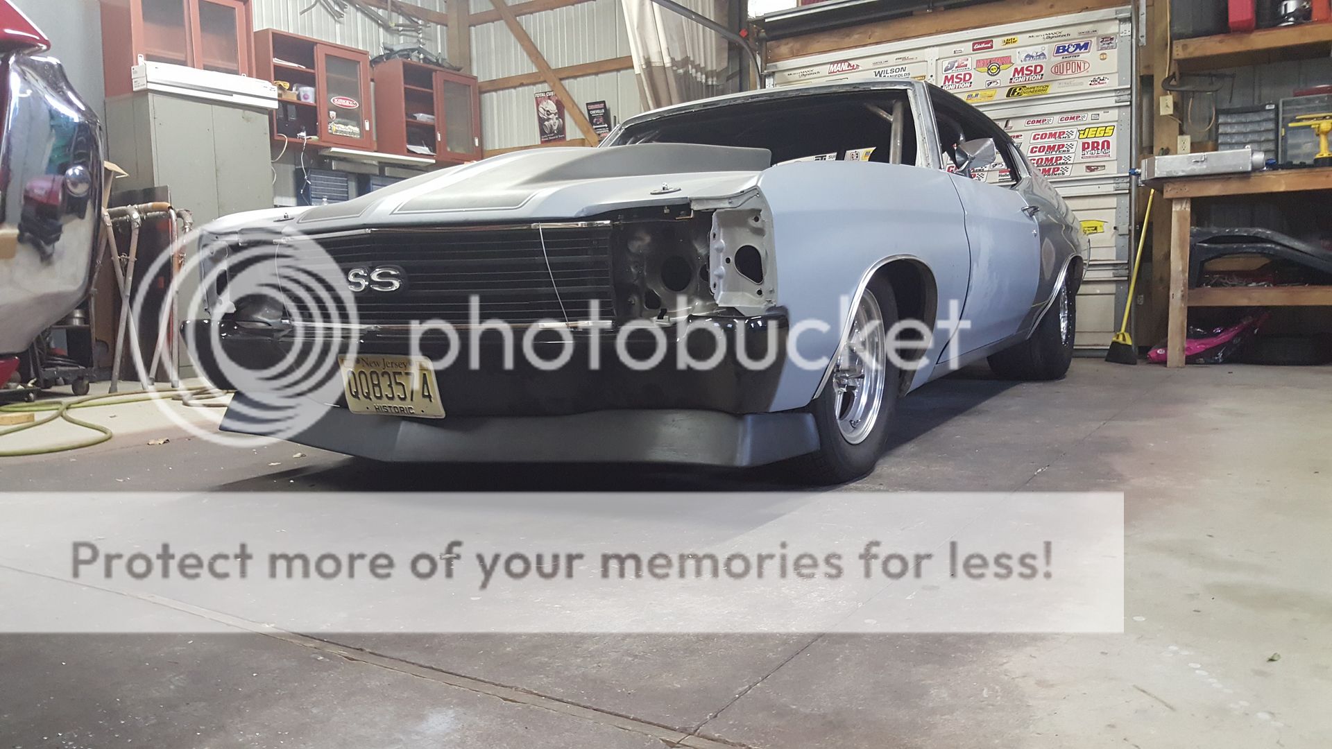

I used SPD when I did mine on my SBC '71 Chevelle. They also make stub tubes that are matched/formed to the header flange. I don't think they listed them in the catalog.
