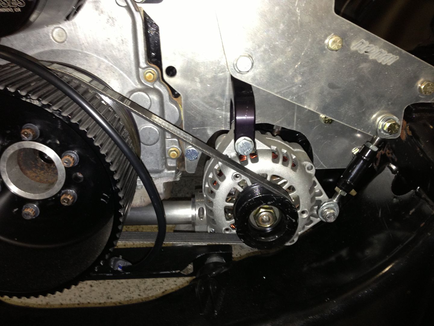

Damn, I forget the guys name that was the resident pro here for alternator shit. I think it was Rayyyyyyyyyy or something like that. Anyway, as you can see in the pic below, my alternator gets a major workout shifting as I have currently been shifting around 7700 rpm. Hasn't skipped a beat. That ray guy is the guy who got this alt for me. If he is still here, hit him up. He apparently has his ducks in a row.
Can you say "22k+ alt speed"? lol I spin the fuck out of this bitch and it has never skipped a beat.
