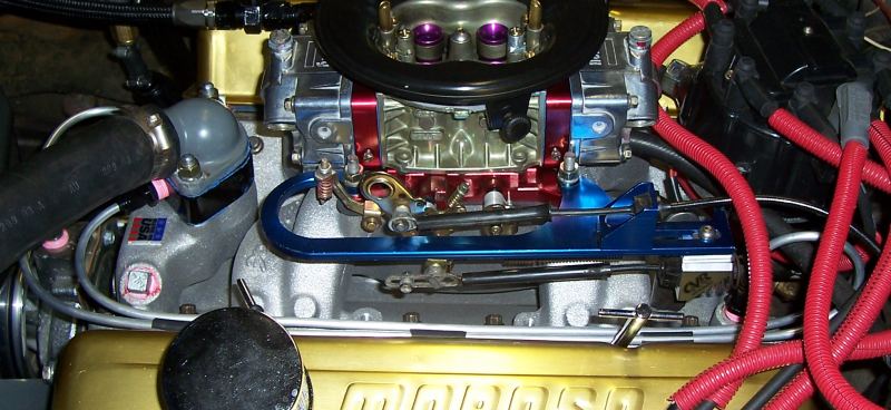

I also like to put water in at the lower center of the block (I use the block drains as an inlet) or if the heads will do it (sbc only here), I like to put water in by the exhaust ports
This photo isn't the best but you can see 2 lines from the pump to the drains, the bypass hose so that a thermostat can be used for faster warm up, and the 2 lines from the rear of the head to the front. There is also a pressure balance line on the front right valve cover and 2 external oil drains on the rear heads that you can't see. Lots of plumbing on this one.
