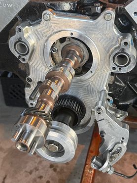

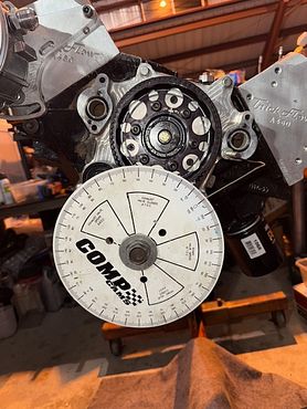

The past few times the 565 has been on the dyno I've used the old setup for the MSD crank trigger with the Danny Bee belt drive, and then switched over the the Innovations West flying magnet setup when put in the boat.
I had some down time before the up coming dyno date, so I decided to pull things apart and get the Innovators West and the Danny Bee belt drive set-up to work together. I needed to make another timing pointer. The new pointer needed to be taller and the pointer needed to be shorter. ..I got it right on the third try ...lol
Put the cut off screw in a drill press and took a die grinder to it as it spun.
