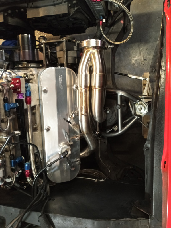

My plan:
EFI
E85
Tunnel Ram A2W Forward Lid from Hogan
Single 118 from Midwest Turbo
Stock Suspension
Small Tire on 28's
Take the car to 25.5
I'd like to cruise it more and maybe sneak into the 4's.

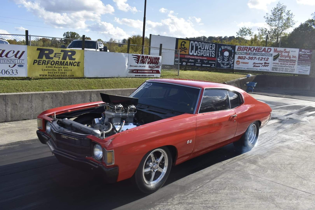

This was last year I believe. It's gone best of 5.85 almost 119. It's a pump gas deal.

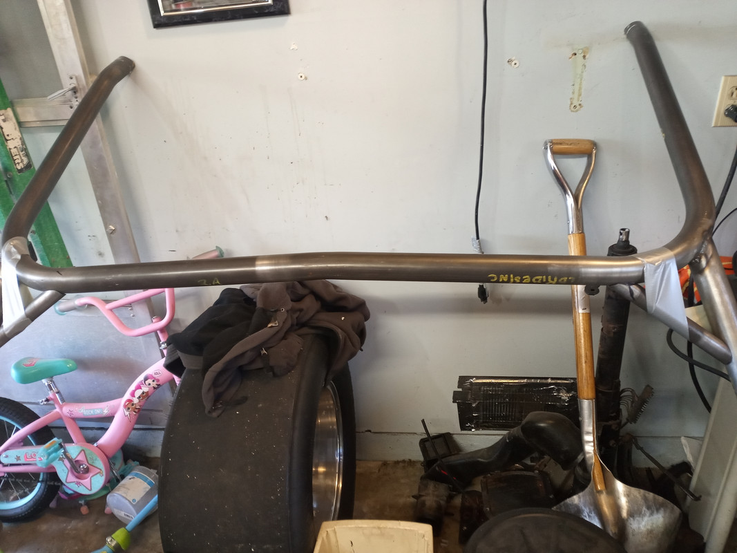

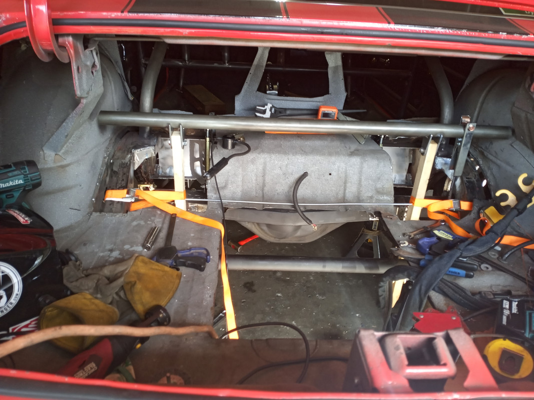

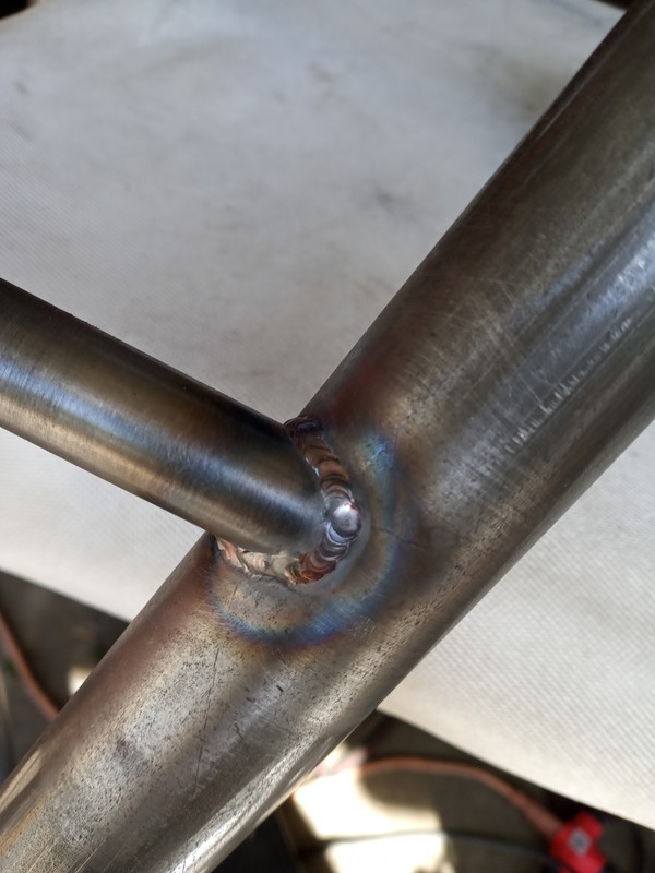

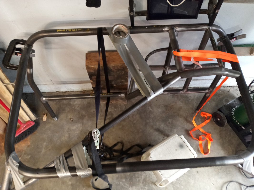

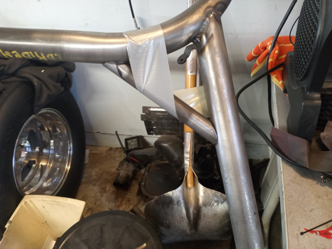

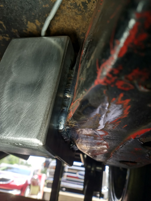

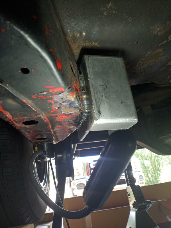

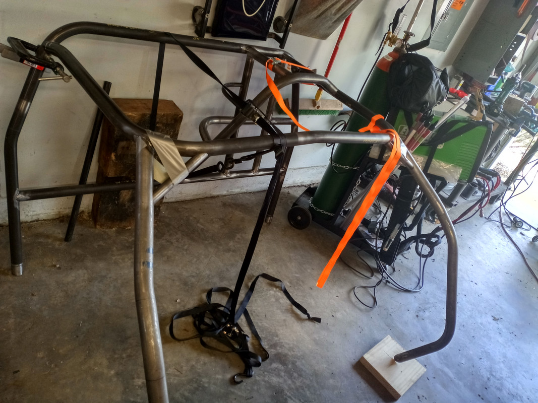

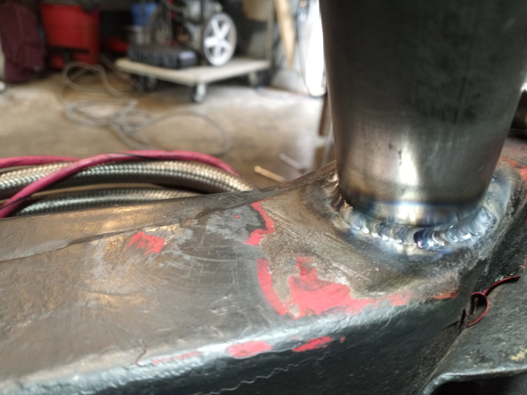

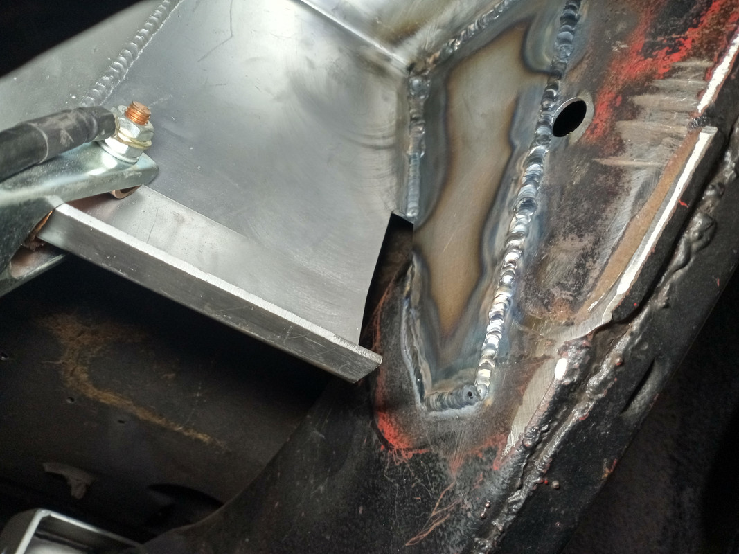

So I'm just starting to TIG. I've done a little MIG. Like install and weld the MS cage in the car. I cut it all out and ordered a 8.50 + FC CM from Wild Rides out of New Jersey. They are a great company to deal with. I test fit and tacked it together in the car. Pulled it out. Built some gussets and roof diagonal.
#7 ·

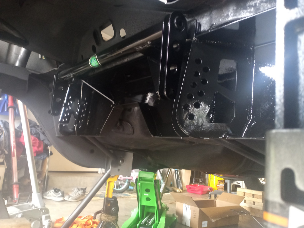

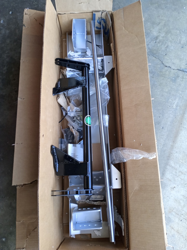

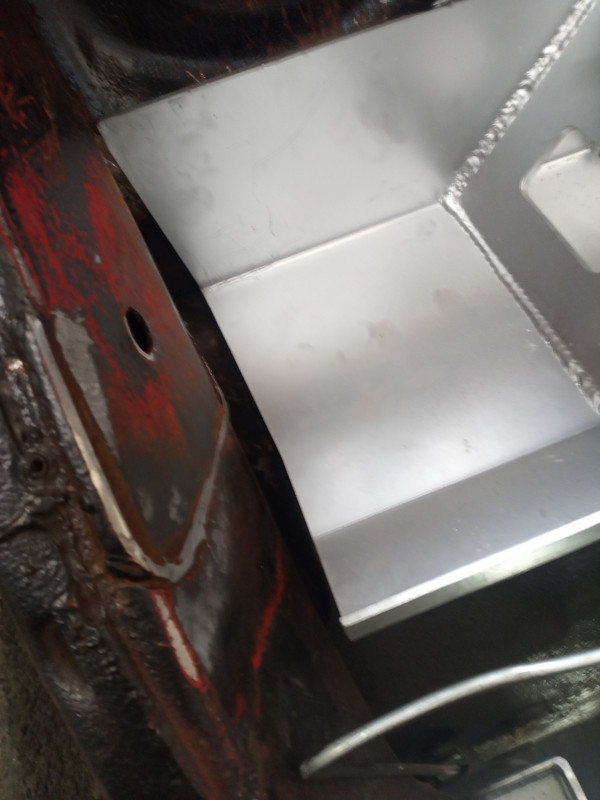

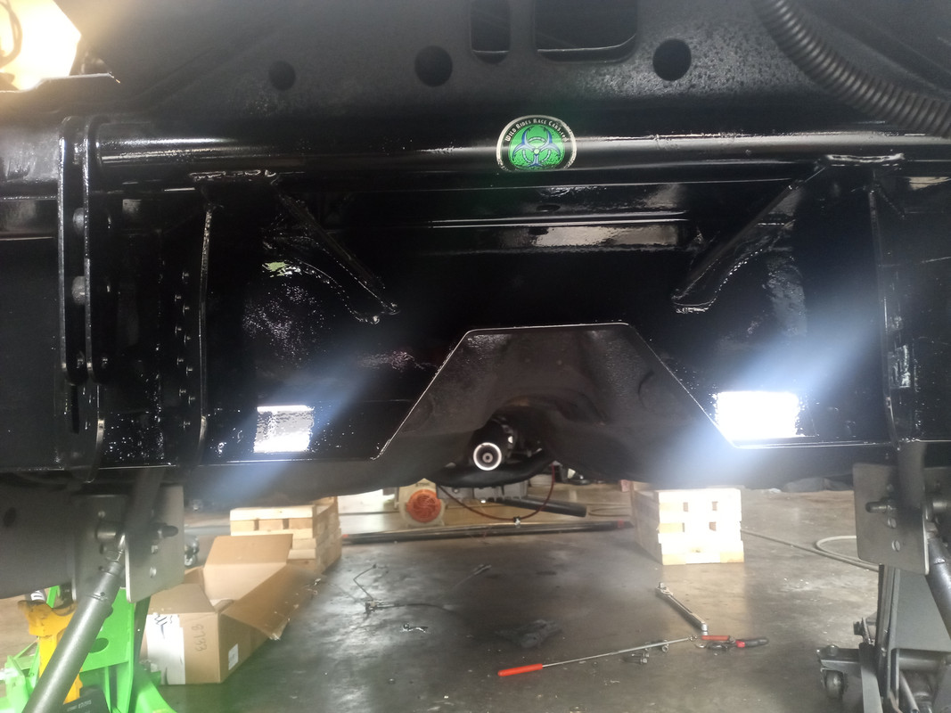

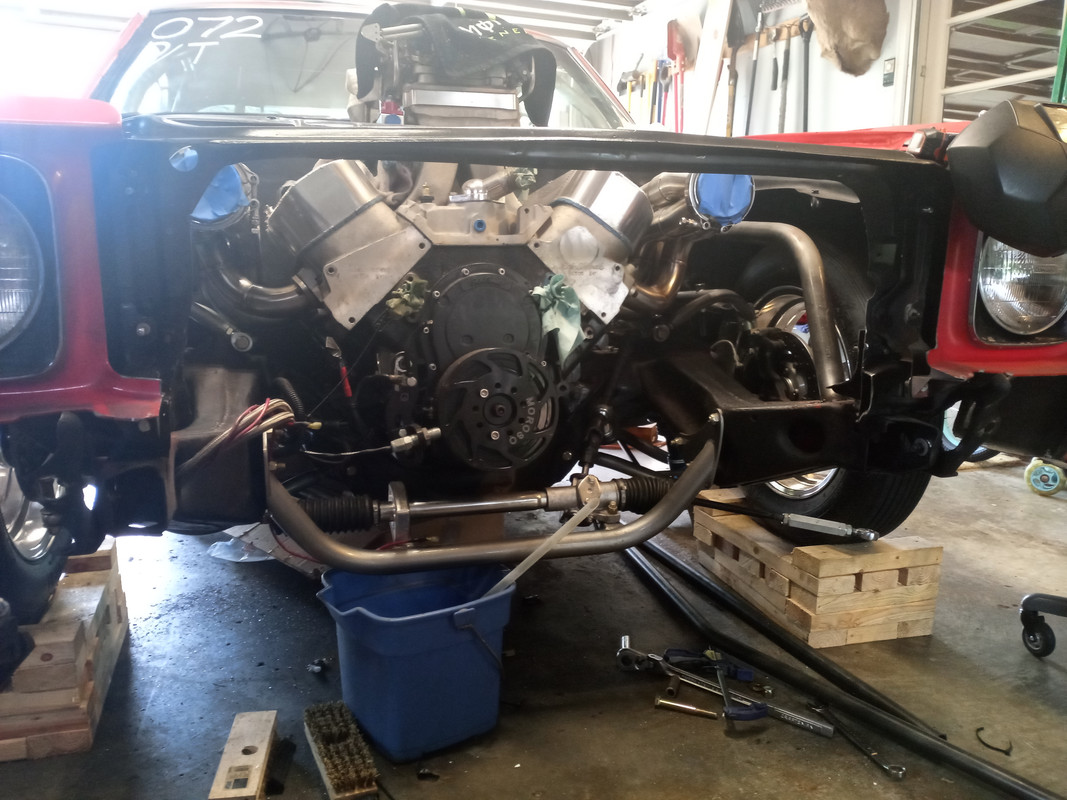

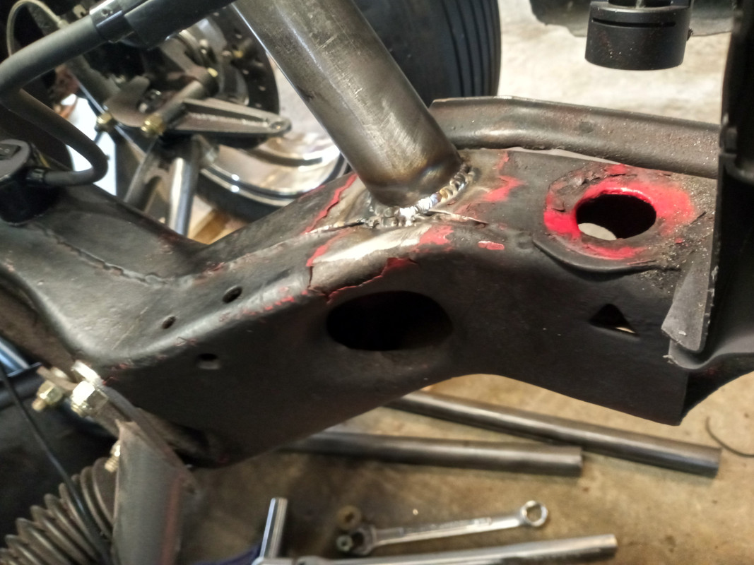

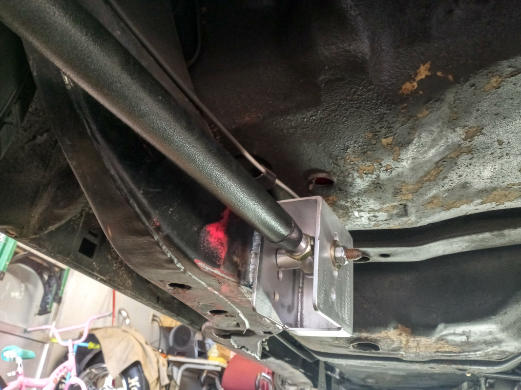

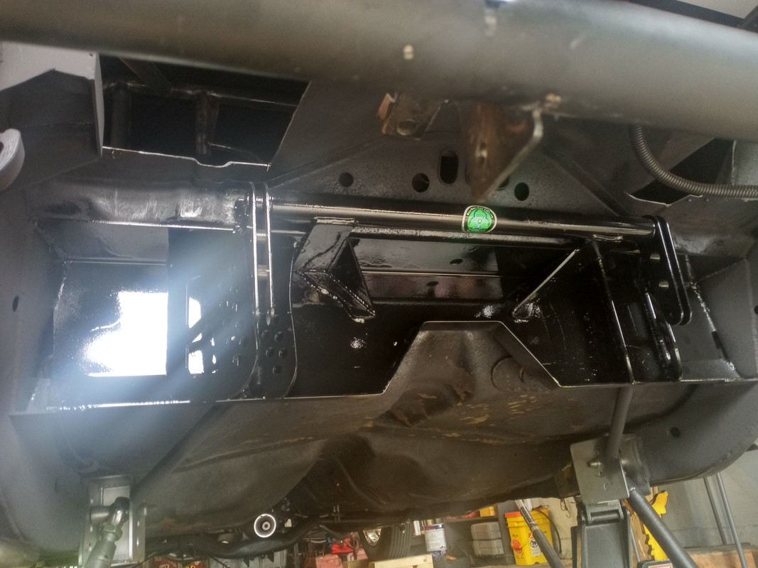

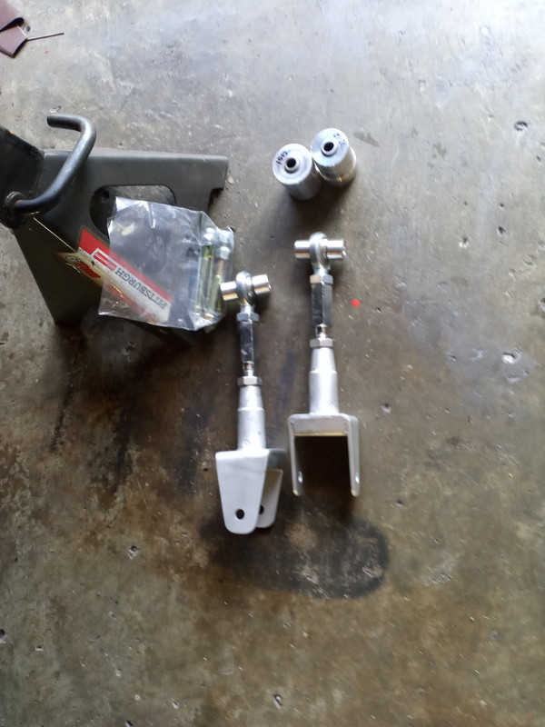

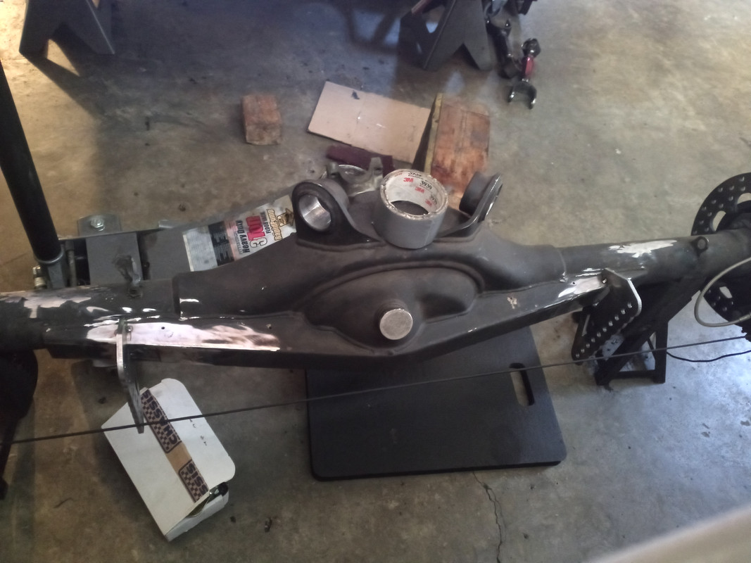

Picked this up from Wild Rides. I'm cutting out the current ARB and factory A Box and Lower Mounts. I plan to tack it all in with a MIG. I'll finish TIG it... I do not plan on going coilover. I'd like to run a long coil spring in the factory location. Hopefully have enough adjustment in the 4 Link for a lot of Anti Squat and control the spring with a good DA shock.

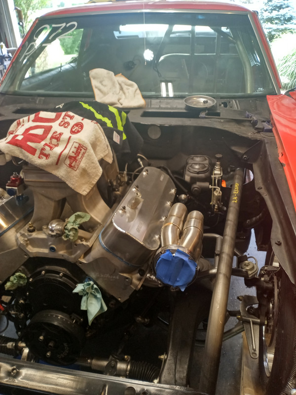

I did not paint the frame red who knows what it's been trough. Picked it up (Chevelle) on Racing Junk. Was in Joliet Illinois. Car is very solid. I would love to know how it spent it's life. Built I believe in Texas as a 350, Column Shift, Factory Air. I bought the car in 2012 with a crate 555 650HP from Musi/Edelbrock. It was a dump truck engine. Wouldn't rev past 5,800. Went a best of 6.8's like that.

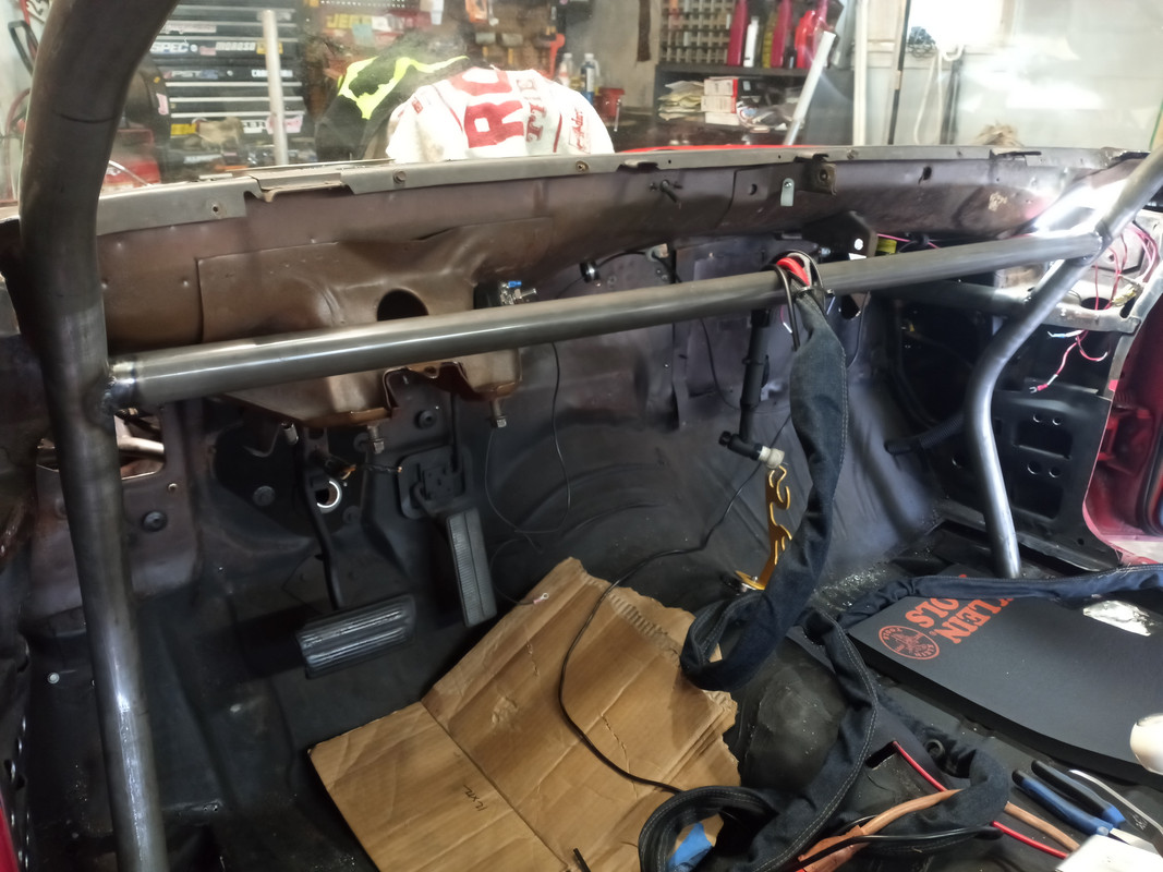

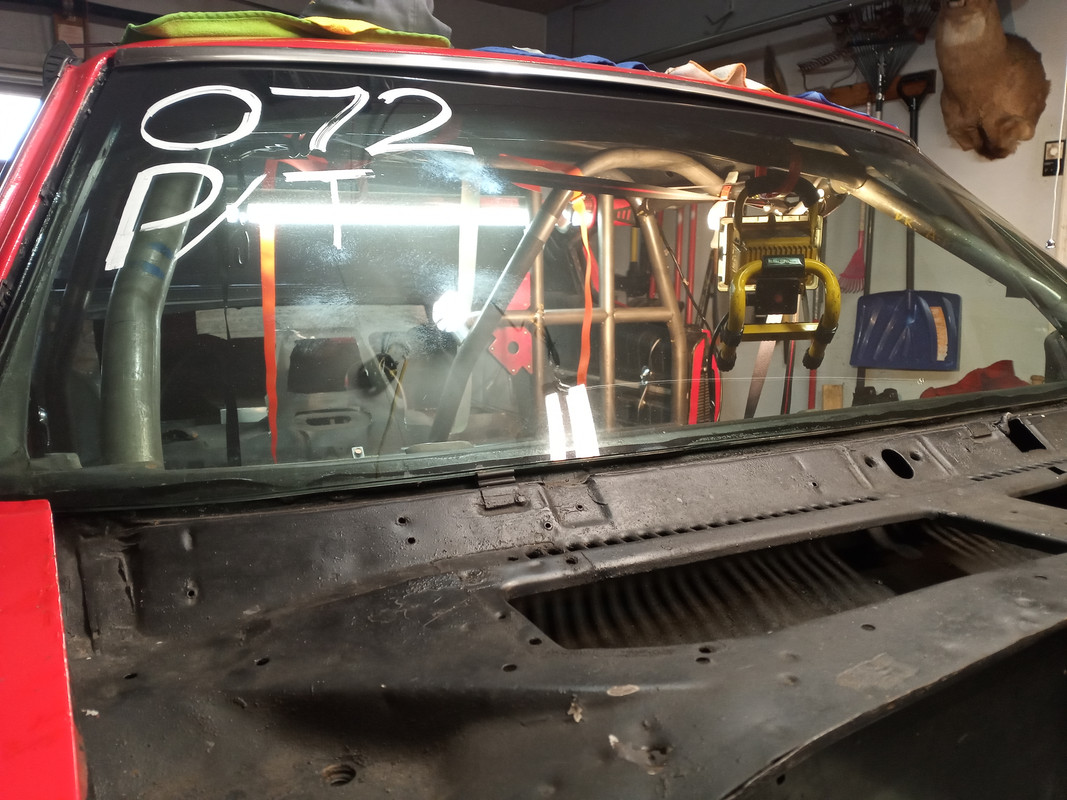

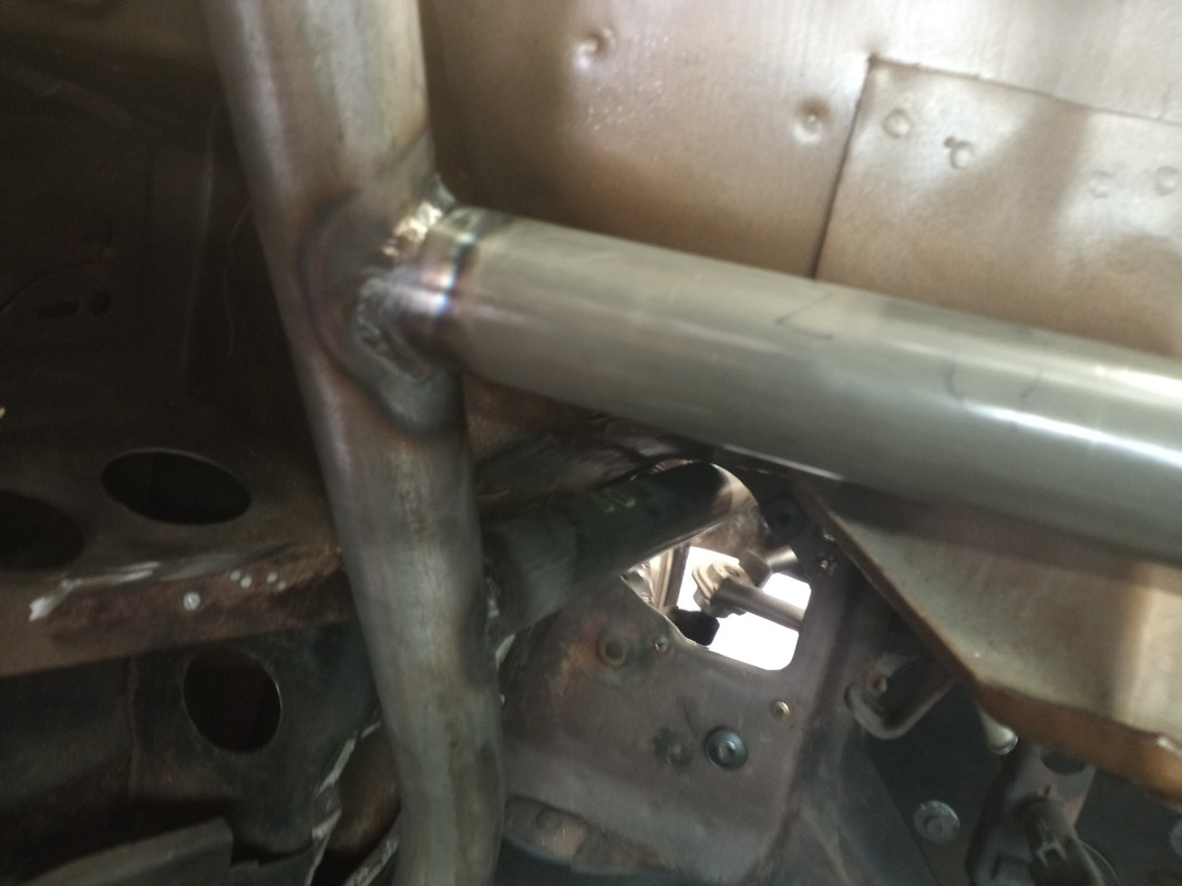

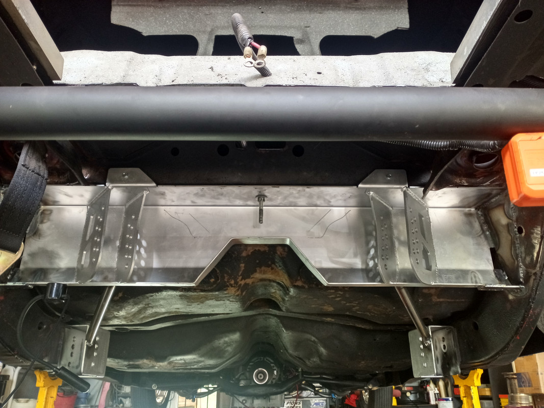

I tacked and fitted it in the car, pulled the halo and hoop, final welded what I could. Put the hoop and halo back and glued them together.
This a something I've never done. I should have cut the pan out. Also would like to get the floor structure done by a local shop, everyone is slammed...

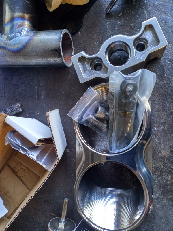

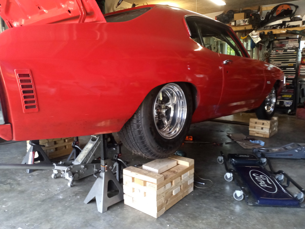

#24 ·

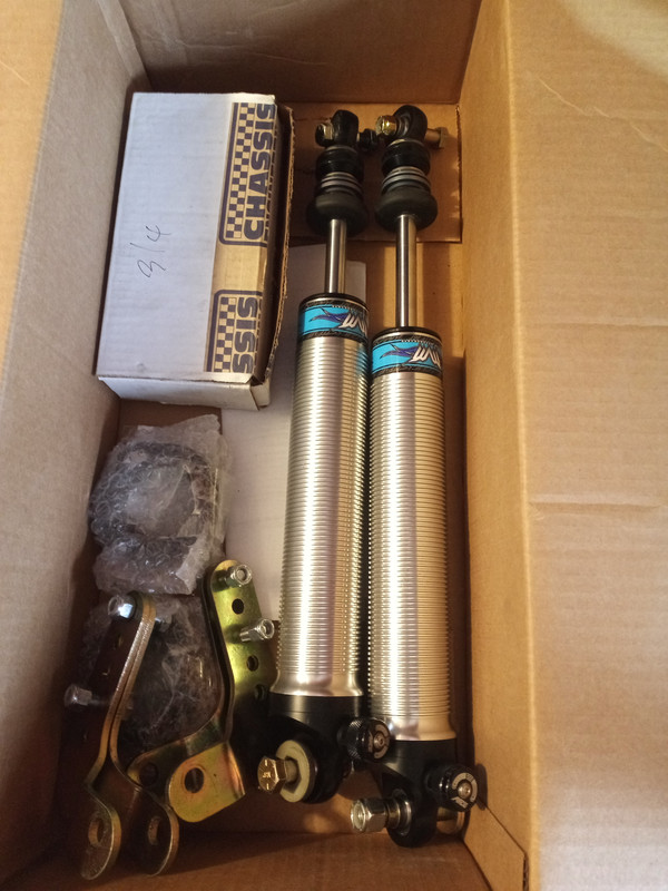

Been on rear suspension. I think I'll grab the Mono Tubes from Menscer. I spoke with them (John), very helpful. Need the cross-member for the the Coil-Overs done first. Looking for 15" at ride height, that will allow me to run 7" travel shock and a fairly light spring. Think I will also send a set of my BS to Mac-Fab and go ahead with double beadlocks as well.
