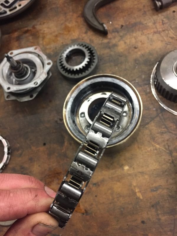

#10 ·
Got the trans apart, but I still need to disassemble the direct and intermediate clutches. There was a ton of debris in the pan.
The low roller clutch seemed to be OK. Rollers were still in place and they didnt fall out everywhere when I removed it. Could this part still be bad if there isnt obvious damage? I will snap some pics tomorrow.

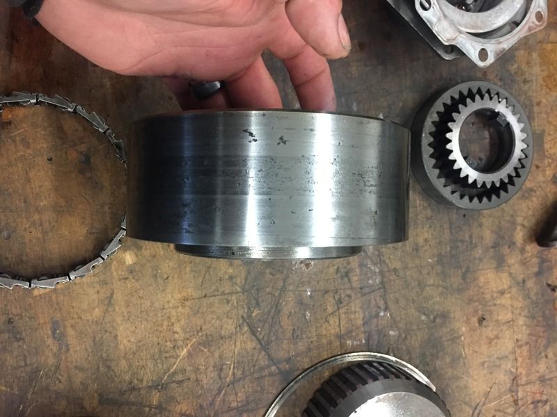

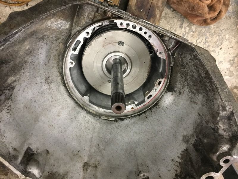

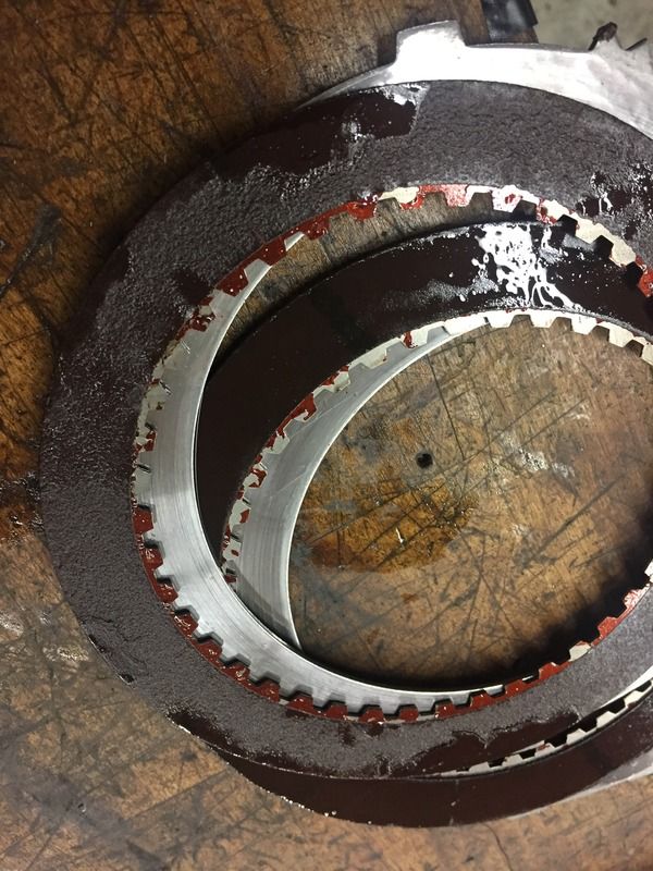

#13 ·
Here are some more pics. The trans obviously had some water in it at some point. The forward clutch plates were all sorts of fucked. To me the pump gears and wear surfaces seem to look OK from a general machined parts standpoint. The part the reverse band clamps to (reaction drum?) has some pitting, but overall isn't scored up. This is just going to be a forward pattern manual trans so I assume this will still work? Now that it's all apart it doesn't seem overly intimidating. The piston seals were all in decent shape from what I could tell.

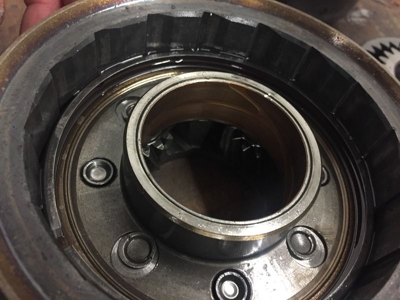

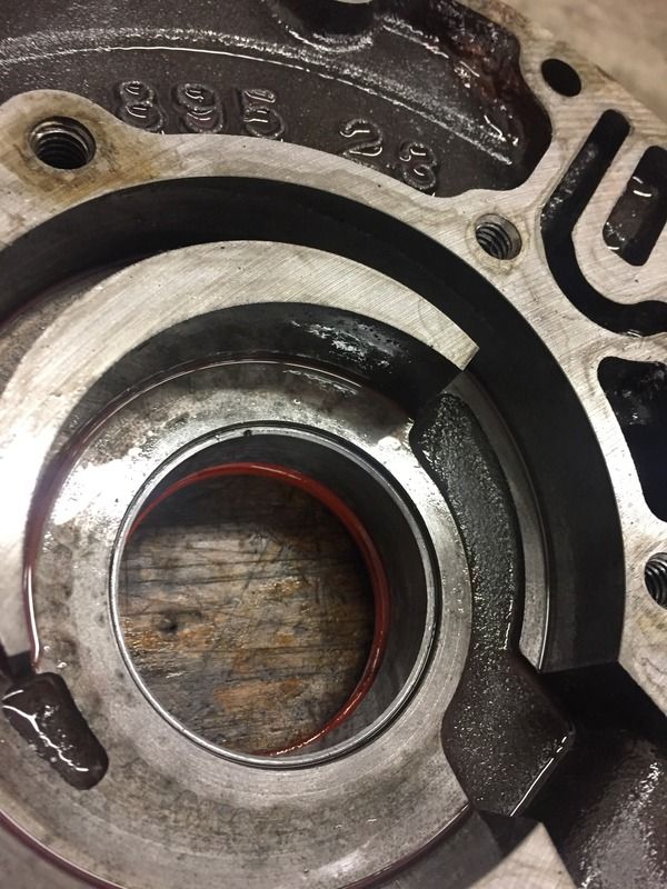

#19 ·
So I've got most of the trans, less the valve body back together. Left the appropriate seals out for the direct feed mods. Using the thick steels in the direct and thin steels in the forward drums, I only had .020-.030" clearance with 5 clutch plates. Machined the snap ring side of the backing plates to get them to .050". Air tested all three clutch packs on the bench and in the case and everything seems to work as it should. Hopefully Ill be able to wrap up the rest of the trans this week and give it a test drive over the weekend. A ton of trash washed off the hard parts as I cleaned them. Nothing exciting but here's some pics.
