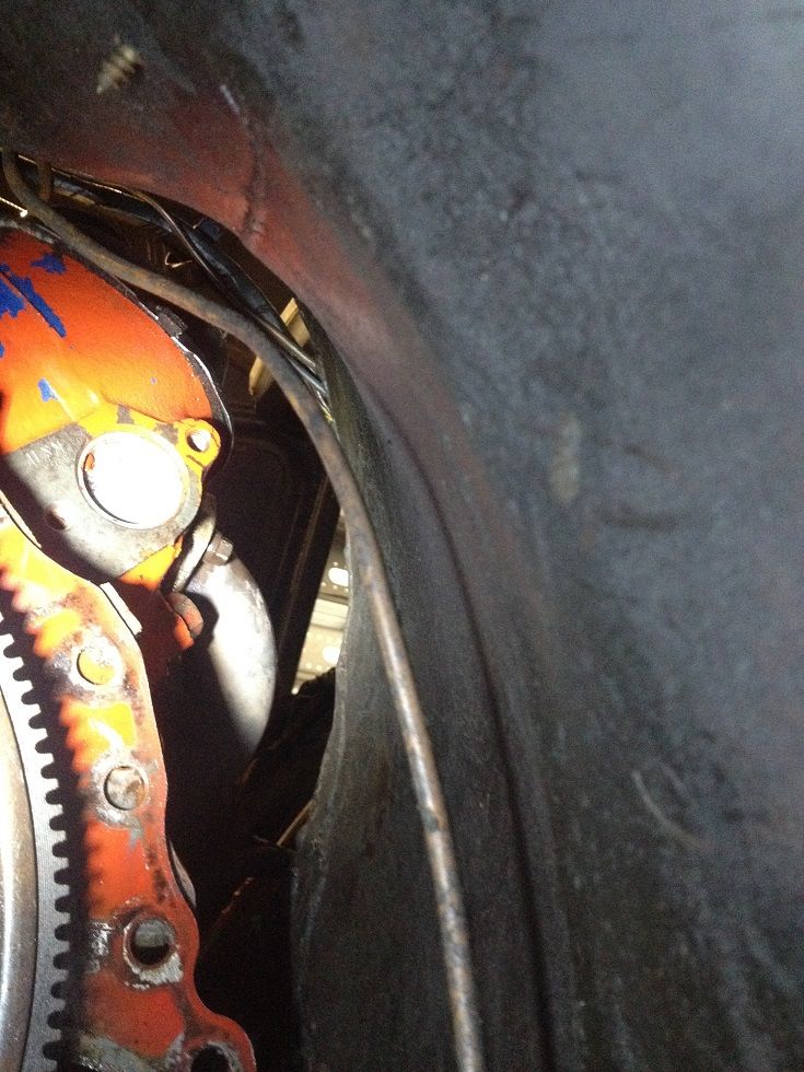

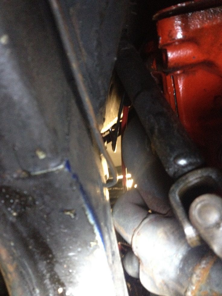

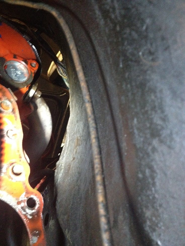

So I have a small car that the previous owner swapped a 289 SBF in. The SBF sits pretty tight. I mean really tight.
Eventually, I'd like to swap in a LS based engine. I think it would be nice to know what I'm up against before I'm doing this swap though.
So I'd love to know if a LS is any wider, longer or taller than a SBF.
I've done some researching and I found that a SBF and a LS are 'about' the same size.
I'm pretty sure its not going to taller, going from a carbed SBF to injection so I don't think thats a problem.
What I am most concerned about is the width at the heads, and the length from the rear to the front of the waterpump.
I took some shitty pics, to give you a idea
Driver side looking up: left is the chassis, middle is steering rod from R&P to steeringwheel, blockhugger header and the red thing is the block itself. This side is the tightest. Unfortunately I didn't get any better pics.
Paasenger side looking up: this is the widest side, I have nearly 3 inches from the cil head to the body, header is only ~ 1 inch though, looks wider in the pics than it is
