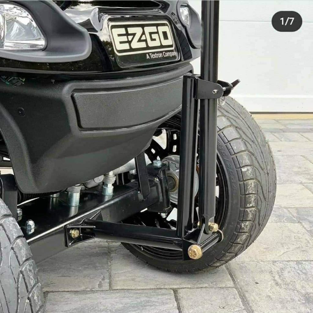

take off the front rubber bumper and that will allow access to the steel frame mounts behind it. right above the front axle. you can tie in there to make the bar with tab to quick release mount to the car. I will see if I can find pics of what and how.
The use of a Push Bar on your race car provides a number of advantages over a traditional tow strap. This heavy duty Push Bar Kit was designed to accommodate multiple mounting configurations because each car and pit vehicle combination is unique.
1320 fabrication custom bolt on push bar mount designed around a ezgo golf cart platform but will work on most manufacturers! Mounting Hardware, quick release pin and a standard 5-1/2ft length with quick release pin all included.
Looking to add a push bar to your golf cart for the track? Team Z offers a kit made specifically for the Club Cart brand golf cart. Utilizing the front factory bumper mounts of the golf cart, Team Z has made a bracket that installs in its place. This kit comes with a push bar and one quick pin...

I have this one (If the link came trough). When not pushing the car it snaps in to the fingers straight upright. When transporting we remove the bar with a pin & put it in the strap rack in the back because it wont fit through the side door when loading the golf cart with it on.
