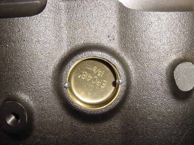

I asked my machine shop about a way to keep the freeze plugs in so they do not blow out like I have heard of happening to others.
My option was to use the thread in freeze plug things, my machine shop said to install the freeze plugs and then drill and small hole for a machinist rivet made of steel and insert at an angle to lock the freeze plug in.
this makes sense and I wanted to get a second opinion from the bullet.
I have inserted a photo below:

Ok, next question. I was going to start a new thread for this, but it is along the same lines.
As you can see the machine shop did not put any gasket sealer on the freeze plugs before they installed them. I asked them why and they said on a new block it is not needed.
I know for a fact first hand, with brass plugs you need gasket sealer for brass plugs on a seasoned block, now is that the case with a new one?

#17 ·
Can anyone explain a little more on doing this? IE: what size rivets, what size hole to drill, etc. Looks like just a solid 1/8" rivet maybe drilled in about 30* maybe? Hows the rivet stay in place though?
Thanks
#18 ·
I watched the machine shop put these in. Nothing complicated. The freeze plug is a little below the block surface, just drill the hole above the freeze plug where the extra space is and hammer the rivets in.
The machine shop said they were 1/8" steel machinist rivets. Drill the appropriate hole for them. Not sure what that was, but can't be too hard to find out.
