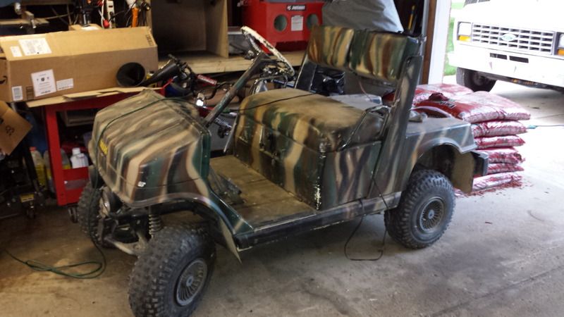

I bought an older Yamaha G2 from a friend and it was horribly painted camouflage. I did a quick rattle can cover-up to get me through the season and I want to restore it this winter and put a fresh (good) paint job on it. I used a single stage paint from Summit racing on the hood of my car and it turned out very well for my first paint attempt. I would like to use the same paint for the cart.
The question I have is, with the golf cart body being flexible, can I add a flex agent to single stage paint ? if so what type / brand should I use ? any help would be great.
