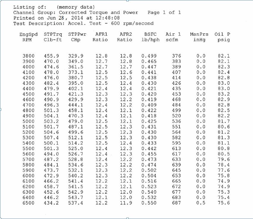

I got one going together too for 2015 with LS power. Did a Gen 1 383 this past summer for it and had great results. Cam was 237/243 @ .050" with AFR 210 heads and it made 543HP @ 6400. Car went 10.91/122 in the 1/4. bear in mind this a full street car, tight converter, 3.73 gear, tail pipes, etc., etc.
Doing a 418" LS3 based engine right now with an AI 317 CNC head (243 chamber mod) and a 253/265 hydraulic roller on a 112lsa with a 108icl, .650" lift on both sides. Super Victor, 950 Ultra HP, GMMP distributor set up. Will engine dyno as well, looking for 640HP and 10.30's NA @ 3200#, same drivetrain.

#32 ·
I use Cammotion cams in my race car
Bob and myself discussed it a few times and I think it came out pretty close
Engine shows just a tick under 800 hp corrected for sea level
Not bad for a cathedral port headed pile- o- poo!!!!!!!!!!!
