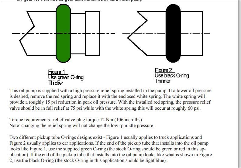

I know they made a couple different sizes, are they year specific or engine size specific?

Color. Blue is thin and Red is thick. Theres some others as well I havent used but have seen pics of green and white ( aftermarket Im guessing? ) Regardless I aim to use the red as default but sometimes it just wont fit without binding, in those instances I use the blue. In car swaps are a pita to up size and its easy to pinch/fold the o ring over. Speaking of which its common to mess these up so be cautious and careful that it goes in straight and true. Lots of oil for ease of install

Interesting. I never really looked to compare when i went from the truck pickup to the Camaro pickup. I used the red on the Camaro pickup though. I bought three seals just in case i rolled one. I have 2 left:cool:
Tommorow im gonna have a look at my truck pickup. I am pretty positive it has the blue seal.
