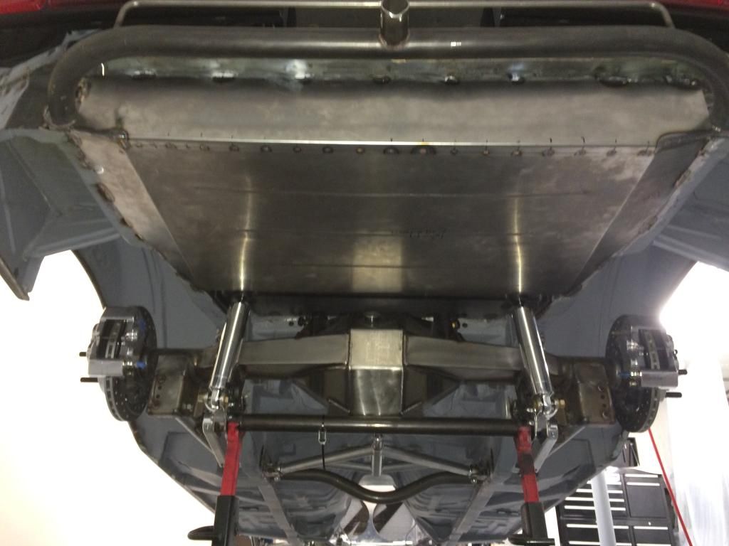

3.5" Aluminum from trans all the way back. Woolf Aircraft TIGHT RADIUS bends are what make 3.5" over the axle tailpipes possible. We did this successfully on a car with a 9" and 8.8" (8.8 pictures below), both with ARB's. However, neither were mini-tubbed.
Good luck, your build is amazing! I have been following your build thread because I am actually currently finishing up installing twin 7675 CEA's on my car too!
Thanks,
Shaun

Looks good.
We took my Art Morrison frame and changed the exhaust openings from round to oval. Oval pipe is the only way to run big exhaust tube and still put the car on the ground without any clearance problems. I have 4" from each turbo to Spintech mufflers and 3.5" tailpipes back from there.
