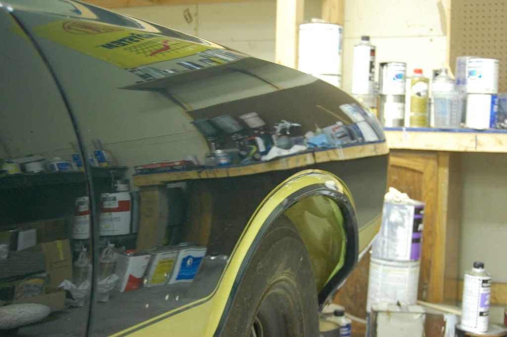

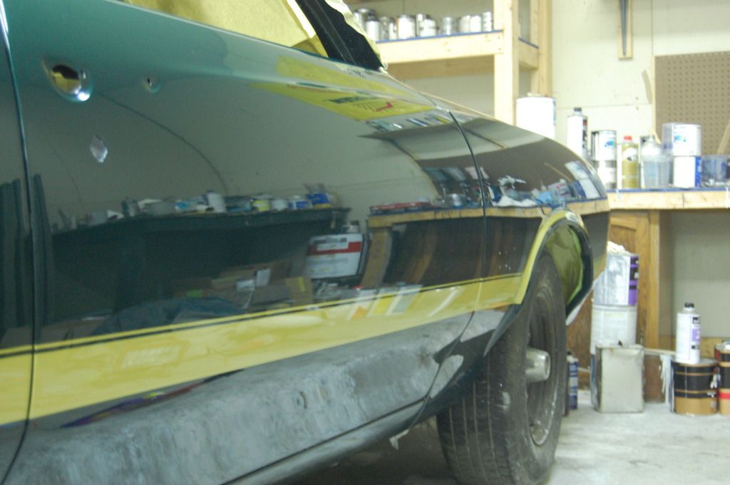

I read about flow coating. 3 coats of clear. Then wait one day and wet sand flat with 800. wash dry and re mask. Then put one wet coat on it. Wet sand and buff as normal. They say this really makes a deep finish. I just did this on a car I had trash in. wet sand with 800 and 1 coat on top. Had horrible results like solvent pop or something. Then had spots show up a few days later like the clear was so thin. How would u not trap solvents in the old clear only waiting 1 day and putting more on it. What was my issue I wonder.
