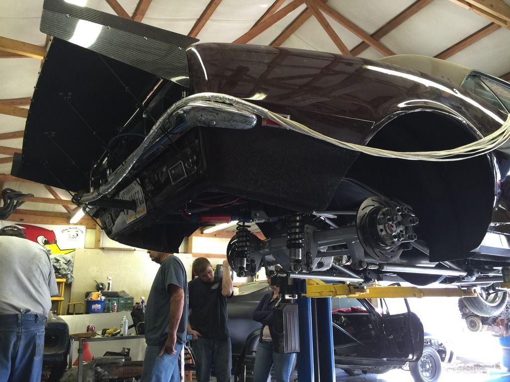

Switching to the 275 pro from a 29-10.5, I know everything I've seen said tight shock setting. Should this be both compression and rebound? Or tight on one and loose on the other? Shocks are strange double adjustables.

I run full front end travel, and use the front shock to control the rate of extension on the front.
Now in the rear I still use a leaf spring, so I don't know if my setup would equate to a ladder bar or not. But in my particular setup the rear rebound side is dramatically tighter than the compression side. The more power I throw at it early, the tighter I make the rebound side of the shock. On a stock valving I ran out of rebound adjustment on QA1 doubles. Sent them in and had them revalved and got about half of that adjustment back afterwards. I will try these shocks with the new combo, but will probably end up with either a Menscer or a Santhuff X shock out back.
#8 ·
It all depends on where your I/C is in relation to your C/G. If the car squats during launch you'll want tight compression, if the rear suspension extends during launch you'll want a tighter extension.
#10 ·
From my understanding the radial cars love to separate on the launch whereas slick cars love to compress on the launch. With that being said, I would think you would want very tight extension to slow the separation down.
#11 ·
That is exactly the case with leaf springs anyway.
#26 ·
That's cant be true, 275 cars don't squat.
Guys, same rule applies that I mentioned earlier, if you're going to tighten one side of the shock to hit the tire harder you have to tighten the compression if the car squats and tighten the extension if the car separates. This is a pretty basic statement for a basic question that the OP asked. Yes there is plenty of fine tuning and every car responds differently to change but that is the basic knowledge of what to do.
#16 ·
Give us a call at the shop 910 491 2798. We would be happy to discuss your combo and options.
#18 ·
I know enough to know ladder bar suspension separates not squats. And we're talking just later bars with radials here. Ladder bars are in the bottom hole right now I don't know the exact * but the are down maybe 2-4*. Worked great with the 29, 1.26 60's with the back tires. With the ft end about 12" off the ground.
#31 ·
I get it, reason I asked is because as I'm sure you're aware when/ if you lower the car it changes the height of the pick up point. Most lower their cars a little for the little tire for the sake of appearance. In your case this would lower your pickup point even further however you have an optional hole to fix this. The thing is with this tire to keep in mind is it's like a stone, no sidewall to wind. With a low pickup point you're asking a sidewall you no longer have to do a lot.
Also with the front end a foot in the air your suspension has little to do with applying the tire to the track, not to mention the stone will make events happen much faster as well as sooner being there is no sidewall to wind. Just my two cents.
#35 ·
You're also automatically lowering the car 1/2" due to the tire diameter change. I might be wrong but I don't think 2-4* down is where you'll want to be for best results.
#34 ·
Send me the message too. :) I'm always learning. I've been low teen 60's on the 275's with ladder bars and QA1's, best being a 1.11 60'. I'm still trying to learn how to go 1.0x 60's. I have the HP.
