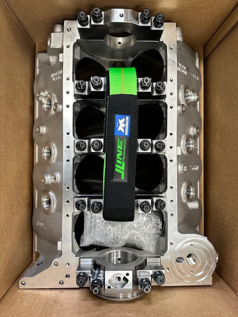

Jason Line has a new BB Chev block. JLine blocks... they're a little expensive but several improvements over a Dart or Merlin.
