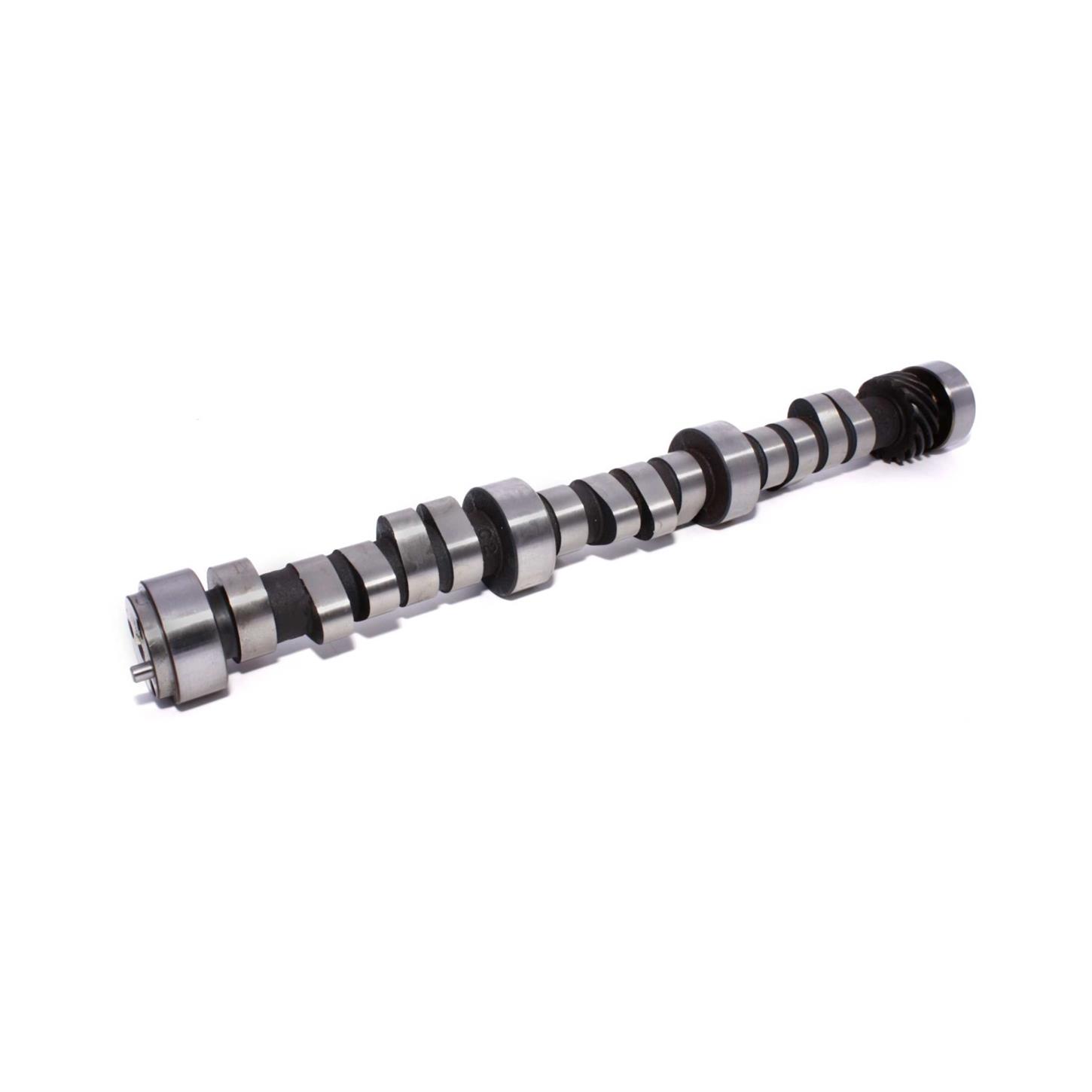

He is going to have the short block rebuilt, but wants to upgrade to a set of later Vortec heads. He wants to run a Comp Cams 270 or 280 HR Cam. It will be backed by a manual, a V8 Camaro T5 if he can find one. He'll be running a Edelbrock carb'd intake and a 500 CFM Edelbrock carb for now. Car has a 4.10 posi rear end.
1. Do the V6 vortec heads have the same valve lift limitations as V8 Vortec heads @ +/- .450" max lift?
2. Are the LS6 valve springs a direct drop in on the stock Vortec heads?
3. Is the 280 Cam too big for a daily driver?
270 HR COMP Cams 18-420-8 Magnum Hyd. Roller Camshaft, Chevy 4.3 V6

I have been told they have the same spring limits and need the same work as a v8 head. there is a video on a cam swap and rebuild of one out there. holder did a bunch of stuff to 1 or 2.
I was watching some of Richard Holdener's videos this evening. The guy does some cool stuff. He likes the 280HR cam over the 270, but my gut tells me to go smaller on the cam.
From searching the web tonight, it seems like the heads will need the same upgrade as the V8 vortecs. I'd like to use LS6 springs if they're a direct drop in. It also looks like he can use a flat top piston from a 350. If he's willing to go automatic, I have a nice 700R4 and 2800 stall FTI converter he can use. I have an ECP radiator for a 57 Chevy that looks like it will fit. I think for accessories he will go with a SWP set-up from a SBC, with a 62-67 Nova low mount alternator kit, or a 69-72 C10 set-up if the alt bracket will bolt to the driver side head and work with a swp. We can test that once he finds a pair of V6 vortec heads, which shouldn't be too hard to come up with, unlike a V8 Camaro T5....
