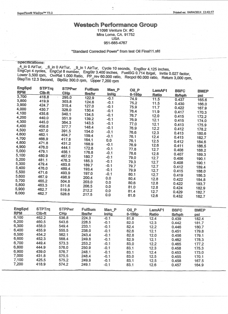

Motor on the dyno made 576 hp @ 6900 and 481 lbs @ 5200.

FWIW, that was a Westech dyno... lol

Has it been on a chassis dyno?

No chassis dyno. You really don't like westech.

I agree with what Mike is saying. The car in my vid put down 448 uncorrected to the tire, weighs 2750 with driver. It is not uncommon to see some dyno's reading a bit higher than others.
Also, not all calculators are 100% accurate. Some combinations will be off in ET/MPH based on the dyno numbers they produced. My car put down 425 at the tire and I weigh 2900-2950 depending on if I use my stock seats, and if I run the exhaust.

Trust me, if I saw a glaring mismatch in your combo, I would be the first to say something. Based on the specs in your first post, it should make plenty of steam... as I don't see anything really out of place. The only thing that might need addressed that you said, is the intake. You might try a port matched Super Victor and see what it does. Don't see it as a major cork, though.

I understand that the dyno said 576, and the track says 450. My question is why? If the motor is not running to were it should/ could run then changes need to be made. That's the reason for this post.

We've talked before. I'm also not a fan of the dyno you ran it on because it just doesn't add up.

Lou, I'd like to note this is all your fault. Being our motors specs and car specs are fairly close. I should be a little slower than you, but not almost a full second.
My personal opinion of the dyno is it's not that far off. Being how close our motors are spec wise and how close our # are. Or it was just a good guess on the dyno to be so close. Now with that said something is not happy.
