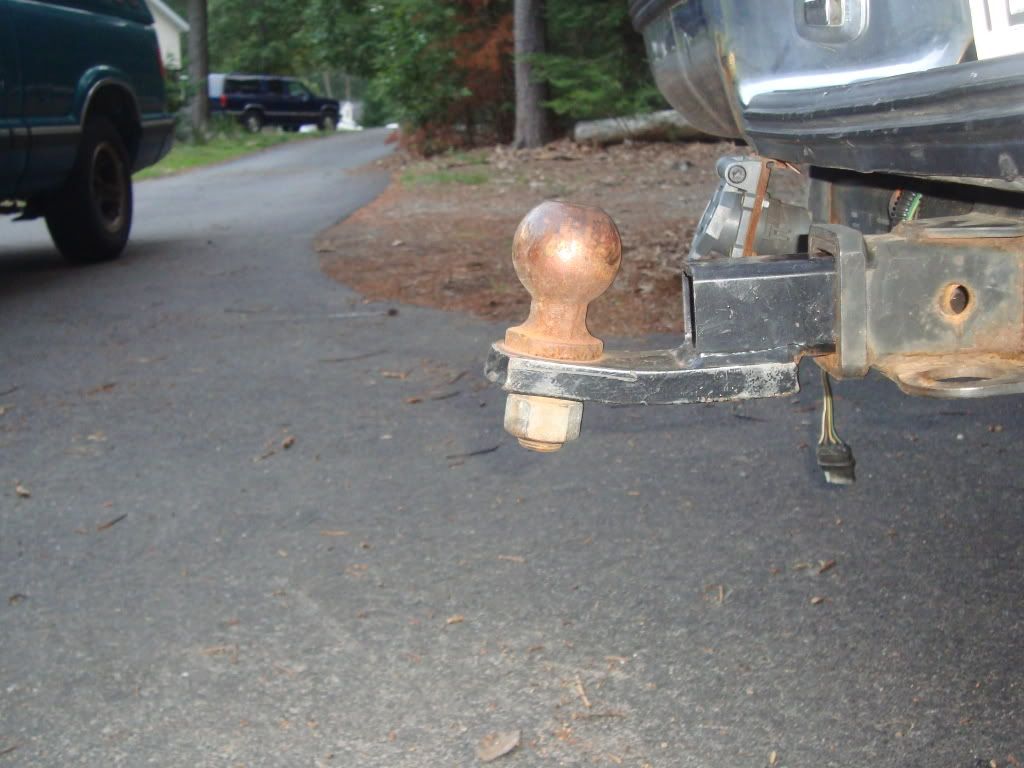

The wife got rear ended by a Buick Regal, no injuries, but check out my trailer ball, It bent a 3/4" piece of steel. It doesn't appear that anything else is wrong. Just knocked off some of the paint. The pin took a hit as well so that junk. Should I put a new Hitch on the truck? What do you guys think.

I'd put a new ball mount on it if you intend tow. I'm not sure the latch on a trailer would latch onto that ball at that angle.

I would just install a new reciever assy ( ball, mount, pin ) inspect the bolts that hold the frame on the truck....good to go

I would replace it myself. But if you like the idea of a hitch that has been hit straightened and possibly weakened. And then if you like the idea of risking it failing while your towing go ahead keep it there. Its only what $40 -50 tops to replace it all? Im just sayin....................

The other person's insurance should cover the new hitch AND LABOR to put it on.
So yes, get a new one.

If you like your truck never drive it with the hitch installed. It works like a lever in a collision and will crush the frame--I have repaired frames that should have been junk but the insurance company wouldnt pay for replacement.

Replace it. If your luck is like mine Id be pulling my Camaro on the trailer and that's when that hitch would give up.

If a report was filed- CHANGE IT OUT. If not you may be held liable if an accident happened while towing.....
