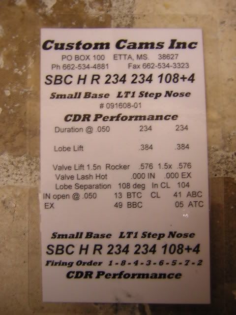

Everyone says this cam is wack for a turbo set-up .
Can someone tell me why it works so well ?
383sbc 8.8:1 AFR195 S480 turbo 87mm / 1.10ar Blow-thru
4450lbs / 142mph on 17psi .
Drives like a dream on the street .

What have you compared it to?
Good question . Never thought about that . All I know is .... it drives great and makes a ton of power for what it is .
I'm just curious why people have told me its not supposed to work well on a turbo set-up . But this cam was designed especially for my set-up .
I know nothing about cams , so can someone tell me what makes this cam a " turbo " cam if its got such a tight lobe sep ?
The only thing I have to compare it to is I was running a D1SC on the same motor at the same boost but a blower cam from comp .
The S480 and new cam went almost a 9 tenths and over 10 mph faster .
I know its all about effecincy between the two blowers , but the cam had to have a say in it also .

The LSA is narrow compared to a typical turbo cam, as you know. You can't make any meaningful comparison re: the cam vs. the switch from a blower to a turbo. If you swapped for a more conventional turbo cam you would have data. As posed your question isn't answerable.
With a 1.1AR I suspect more exhaust duration and a wide LSA would be better. But it's just a guess.
