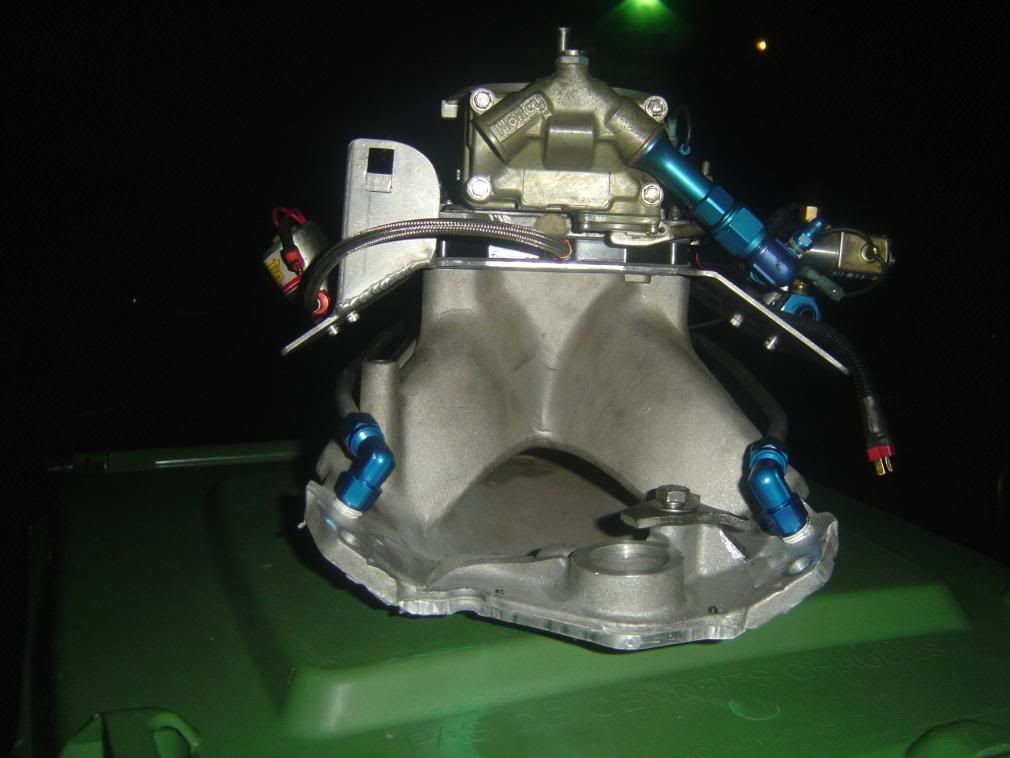

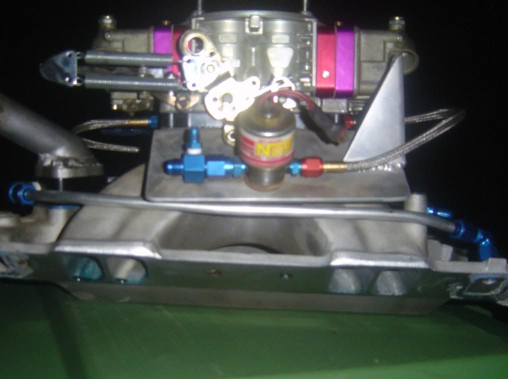

This is for a small block chevy, drag race only. currently running 275 in the plate and dont think the distribution is good as i want. I would like to use a fogger , but quite space challenged. the aluminum plate holds the solenoids for the plate kit and the throttle cable, so I kinda need it. I think I can trim some places to get lines through, but the out of the box kits dont seem like they will work good. any suggestions? Oh I probably will use the fogger as a second stage, with @ 150 hp jetting, and use the plate (already on the progressive controller) to leave on.
There is about 1.5 inches in between the intake and the plate

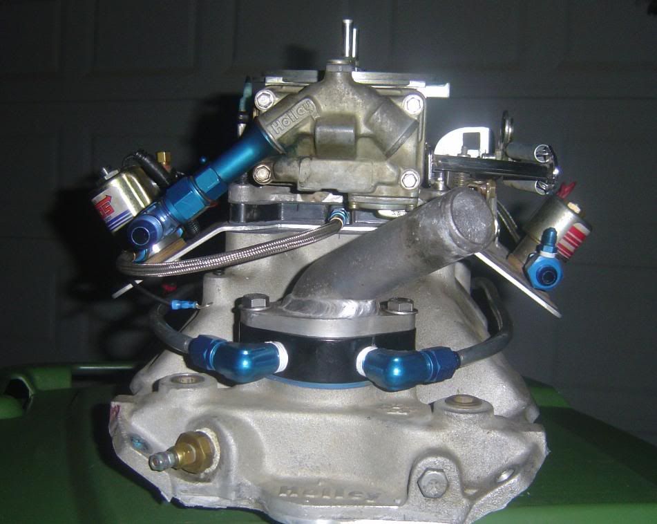

We have done quite a few small block Ford and Chevy intakes like this. It doesn't look like a big deal to put a direct port kit on it, just need to move the two solenoids for the plate and trim up the throttle cable bracket a bit... No big deal... SJ

I have seen a few of you setups, and they are very well done. I was thinking of using an e3 nozzle so i could turn the inlets flat, would that work?
