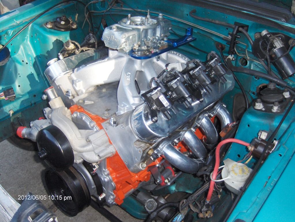

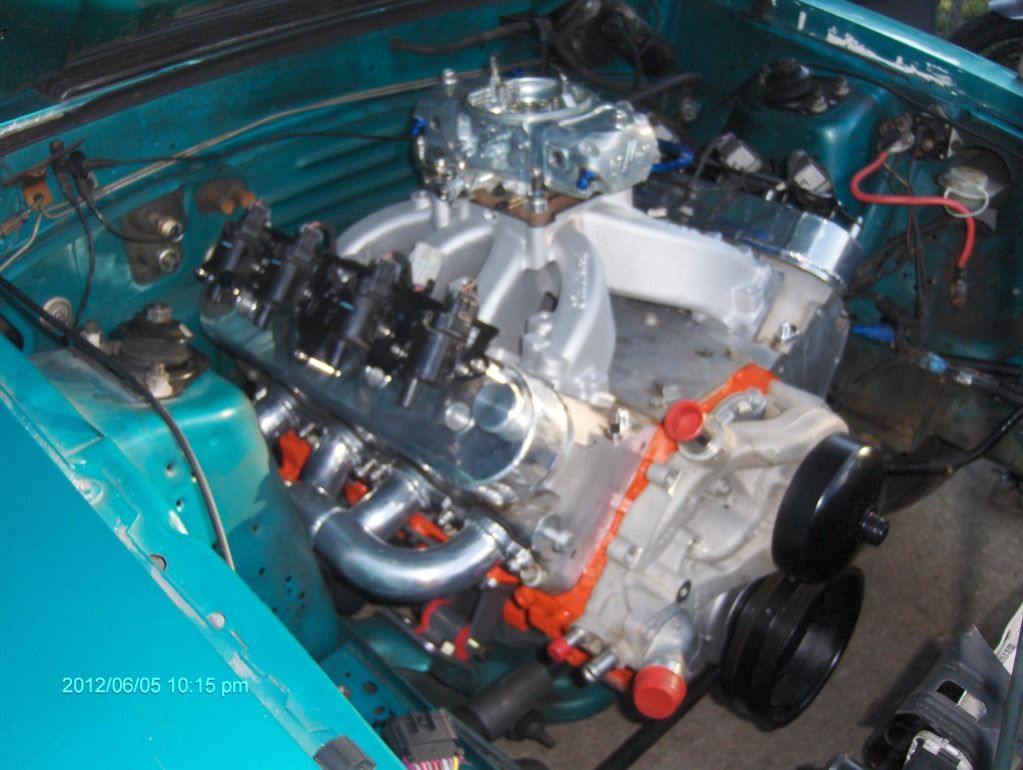

Wanting to run in the 10's
1993 Mustang coupe
6 liter ls with L92 heads
9.75:1
Comp cams 277 with 227/235, and 612 and 624 on a 113
850 Race Demon
Edelbrock Victor Jr
1 7/8 into 2 step header
Turbo 400/brake
5000 Precision Industry Spragless convertor
8.8 with 3.90 gear.
28x10.5 DR
4,397 Posts
Should go 10.50 s all day at that weight. Does it have stock pistons? If so i would keep it a tad rich or at least run 100 octane,they like to break the tops of the pistons off when the ring gap tightens up.Good Luck!!!
4,488 Posts
Knievel on here went 11.90 with a dead stock 6.0 with 317 and stock cam.
Converter my be a little tight
But should go 10's without much trouble
Tim
1,870 Posts
ive been 6.50's @2790 with a lq4 with a zo6 cam and i went 6.70's bone stock...
Chupa Cabra
9,824 Posts
I had a set-up very similar only with 10.25:1 compression, 346 cubes and a bigger cam and slightly looser converter and went mid 6.40's all day in decent air. [email protected] in the 1/4 with a 6.53 1/8th mile time.
