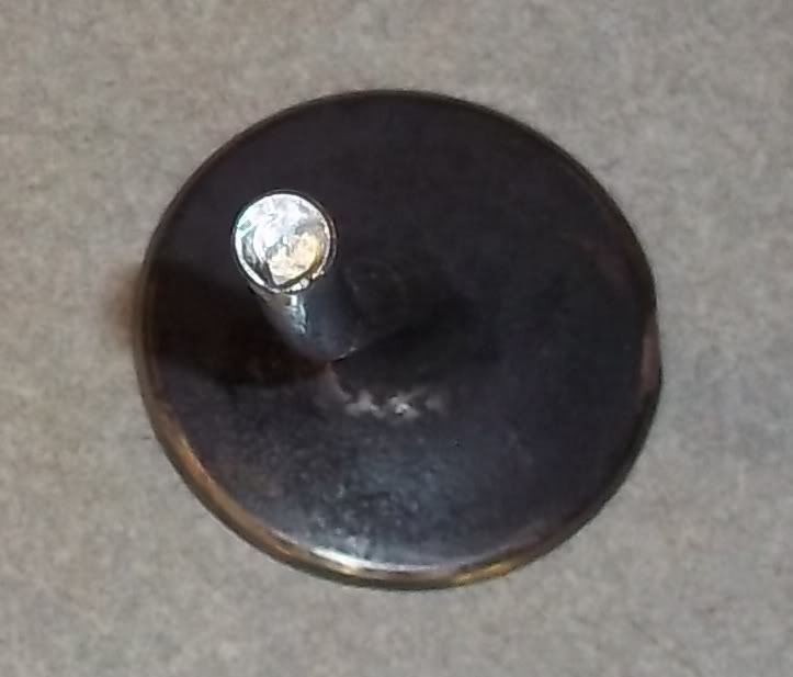

the tensile strength of the material makes it hard for me to buy that it just broke all by it's self, ..
valve float, . . valve hitting piston, .. something had to influence it I would think.
is it a valve from a manufacturer you trust?, .. I'd call their engineers to have it looked at.

Could have been a valve defect, but typically a failure in that area can be traced to either running an off-set lock to gain more installed height, or a less than optimum retainer/lock design. (or a little of both depending on use and system control)
Under extreme stress, if the retainer/lock design is off slightly, as the retainer flexes, all the load will target the top portion of the lock.
Again, could be a bad valve, but something to look into anyway.
7,226 Posts
Would be interesting to look at and measure the retainer taper, locks, and stem just to see how the load was spread. If it's an 8 cylinder you may have 7 more chances to figure it out.:p

I've heard this is a problem with those retainers that are all one piece (split but includes lash cap type top).
What kind of retainers did they run?

It's a pump gas Big Chief engine. Picture of spring assembly and the retainer/keeper. It has that funny looking bronze looking, bump in it as well..
PS, to avoid the wrong idea of the valve manufacture, it's a 35 year old company I totally trust.

Could also be too high of seat pressure for that particular valve. Ferrea told me no more than 300 seated on their 6000 series valves. Also once the locks are installed doesn't the "collet" action of the lacks hold the on with the taper and not the groove? Seems to me that if the locks didn't fit the valve/retainer properly the valve would take the beating in this area due to the locks hammering the groove. Like said above.

Wow, Are they used retainers??, they look like shit on the bottom........ were they the same company for reatainers and locks??

Pretty sure Ferrea doesn't make a 6000 series for the Big Chief, and a lack of spring pressure would be more likely to cause this than too much.

I'd be looking at the rest to see if there are any tell-tale signs...but we know that sometimes stuff just happens.:smt102
Those retainers do look a little beat up.

If it makes any difference this is a Speed Week engine.. All USA parts.
Are you sure about that? I thought the only 2 companies actually manufacturing stainless valves for the aftermarket were Basso (Argentina) and Eaton (facility in China). Everyone else buys their forged blanks from them.

Some guys don't get the demands of Bonneville. WOT for a minute is hard on parts...especially that valve train.

Wasn't talking about the valves. Talking about springs/locks/retainers.

Just notice this, are these valves magnetic?
