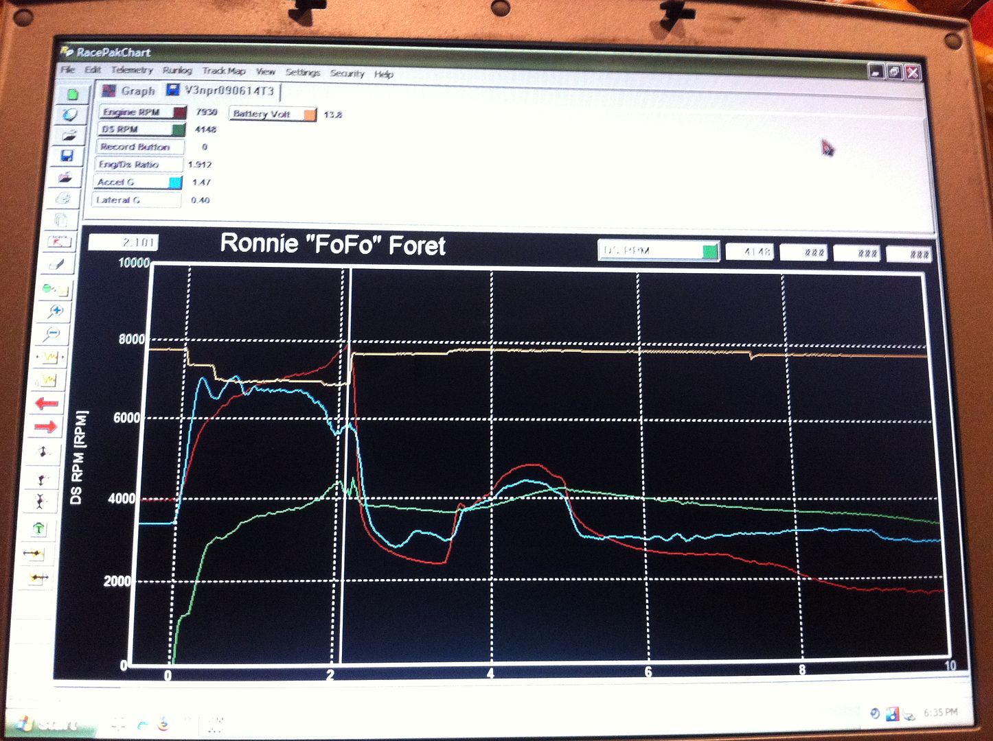

Run1 Graph: Left good, went right down track, peddled it, n20 on & off again, still 3.12 4.70 156 lifting at 6.4 seconds 7.26 179 scrubbing about 17 MPH.
Run3 Graph: 2nd stage on @ .35 seconds vs. 6 in Run 1. All good until the car again moved right & did not shift in to high gear, 8000 when I lifted.
The data seems to suggest that we need more wheel speed sooner in the run, as we are not close to getting up on the tire, even with two stages on in .35 seconds.

The early #s (DRPM, ERPM, ACC) definitely got higher as I turned the 2nd kit on sooner from .65 in Run 1 to .35 in Run 3, & the graph looked better too. Remember too, the GOW was about 130, ambient temp about 100*, & track temp about 130*, so we are relatively down on power as compared to just decent air conditions. The Converter is a bolt together Super Mega Coan that came out of the 02 Camaro with 738 cid & Glide. On Run 1 when I lifted & peddled, & it recovered & went 4.70 @ 156, the slippage was still respectable 8%...I think it will go to 5% when I make a clean pass...of course, it locked up 1:1 long before the 1/4...even scrubbing about 16 MPH.

Steve,
Run 1 with 2nd stage on @ .60;
DRPM
.10 198
.20 250
.40 2326
.50 2701
.75 2408
Run 3 with 2nd stage on @ .35;
DRPM
.10 1057
.20 1291
.40 2832
.50 3061
.75 3265
Remember, big tire, back half car, 2900#. Also note air & track conditions...South Louisiana in the summer time...LOL.

Jamie, you might be right. The track did get hotter...we made the 1st Run at 11:03, & the 3rd Run in the heat of the day at 12:33, when the track temp was hotter. The video was actually Run 2 where the #s were in between Run 1 & Run 3. Run 1 was the best 60', although Runs 2 & 3 might have hit the 60' beam under the car. , My "seat of the pants" driver perspective feels as though the tire is rolling over itself, as it always has, & is no where near getting "on top of the tire". I wish I had taken the time to position the GoPro on the rear tire, but we were rushed to make each Q round, while trying to beat the rain.
