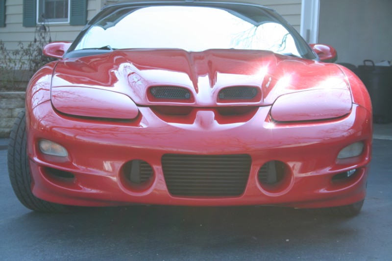

As you may or may not know we got the back from the chassis shop last week. It was gone for a LONG time, and while it was gone the work that was planned just piled up. Well now that it is back in our hands the work can once again begin! I decided to just start an actual build thread to keep it all organized, so this is the thread for updates this season.
Two years ago Chris (owner) and I built a truck manifold turbo kit. Turbo kit uses a Precision GT42-76, Tial 44 waste gate, and Tial 50mm BOV.
The car used a walbro 255 pump, 60lb injectors, a LS6 intake, and MAF tune (didn't work out so great) 460ish WHP @ 6psi...

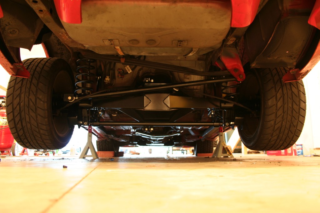

Suspension is All Midwest Chassis Everywhere.
Rear Lower control arms, and panhard bar

We started this weekend by mostly pulling out some weight, and generally got the car ready to carpet. I don't really have any pictures of specific work on this, but basically I chopped out un-needed brackets, pulled excess wiring, and anything not needed. Chris got to work pulling the crash bars from the doors, changing the rear brakes, swapping out the rear control arms, and panhard bar to Midwest Chassis pieces. On with the pics.
