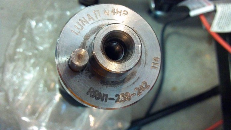

I used this cam back in 2002 and got 14" vacuum installed straight up in a 302... Now I have a timing set that will go +10* in any increment. Anyone else get a bit on the edgy side for their daily driver with suprising results? Did it have the "parking lot jerk"? or were you able to tune it out? I am kinda anxious to try this out again as I have learned quite a bit about tuning since '02. Clutch out, off idle initial acceleration is my most picky spot that gets a lot of attention when I tweak on the tune.
1,974 Posts
Discussion Starter #2
Timing events installed straight up are..
I.O. 9*
I.C. 49*
E.O. 59*
E.C. 3*
on a 110* ICL
