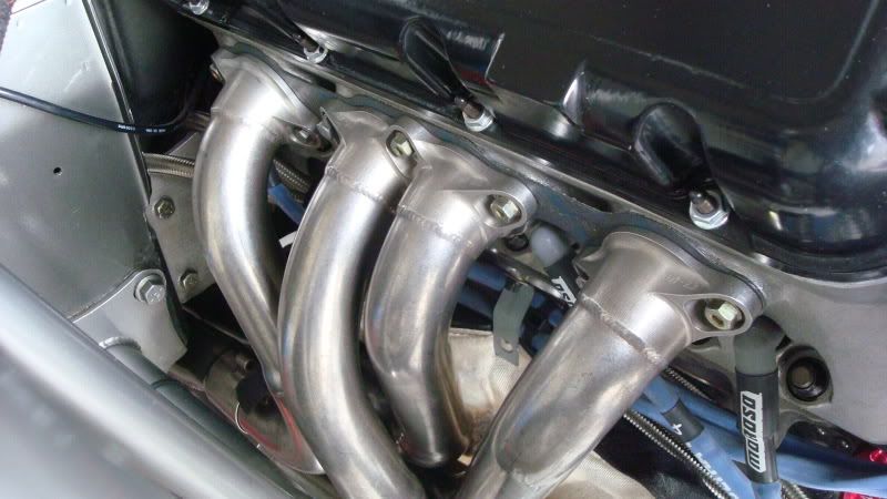

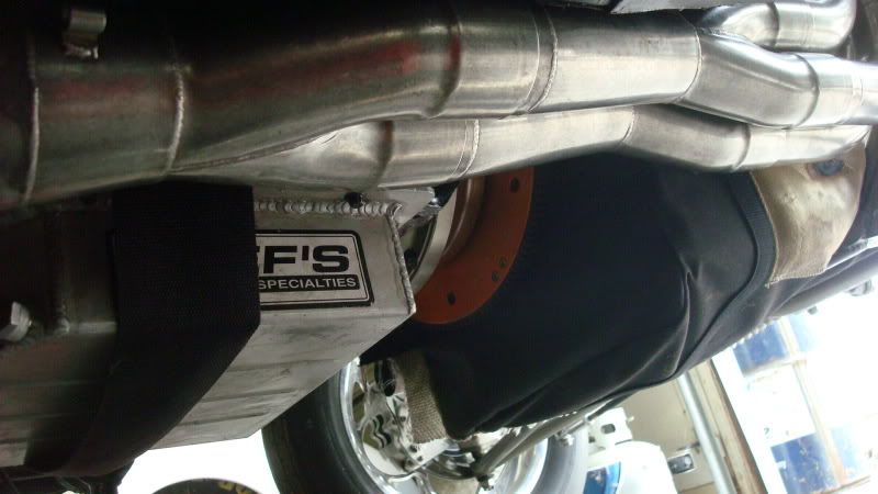

Got some used inconel headers for my car, going to try out these tri Ys..Had to switch around the header firing order a little..Have to weld in some new tabs. These things are Light!
What are guys using for rod to weld inconel? Any special technique?

I recognize the design. They were made by Weiss in Indy. I have seen quite a few sets of theirs in Cup Land. They make really nice stuff. With the Inconel, you need the biggest cup you can get and keep everything clean around it. You need an awful huge amount of gas flowing as well. Also back purge and even use flux if you have to. Most people find it hard to weld this material.
I use mineral spirits and clean it before welding that stuff. Normally we can get away with the material as thin as .029, thats why they are so light and durable.....

Yep Weiss headers, really like the flanges. :)
Thanks guys for the tips...found some ERNiCr-3 in town today. Worked GREAT! Wasn't too bad to weld.
Got all the fab work finished, and the firing order right, and back on the car...cant wait to hear it run with these headers:)
