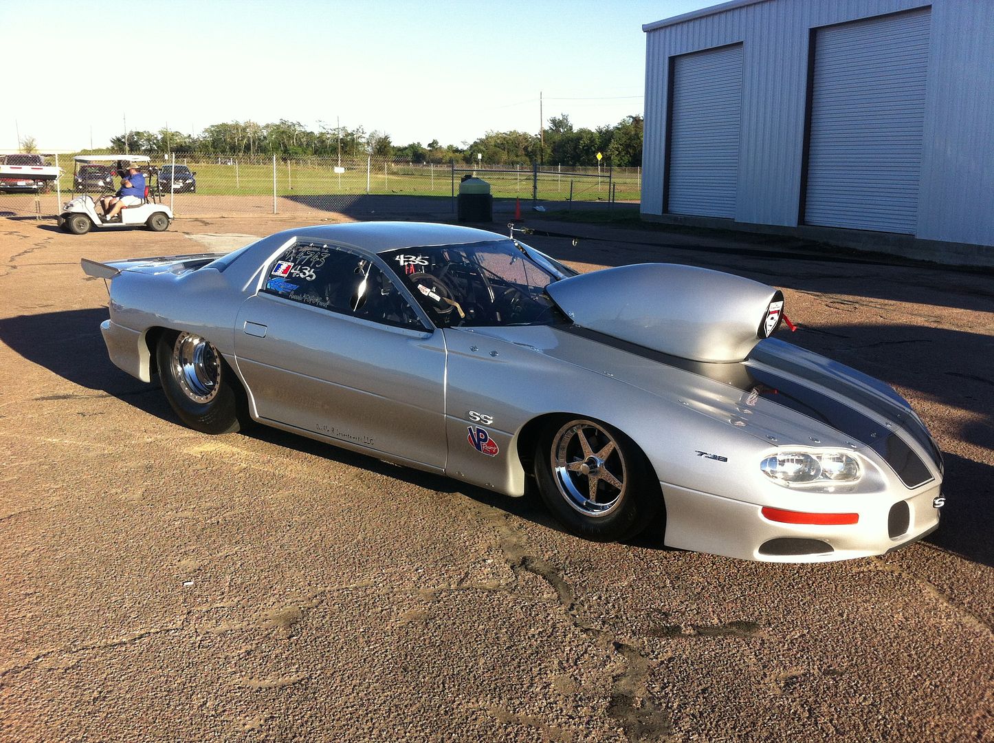

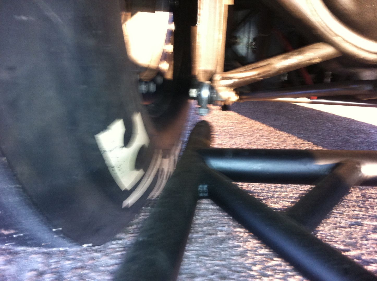

Some photos... I will post the GoPro video of the run when the wheelie bar heim broke, if I can get it downloaded...

Several things could have broke the heim Ronnie.........One, it just slammed the bars into the ground and broke it, although that generally breaks a top one. Two, tire shake. Maybe just shake in general...........but........if the tire is close to the lower bars, a wadded up tire will actually grab the bar and snap the heim off. Look at the bar and see if you can see where the tire touched it. Happens all the time on Pro-Mod cars, but since they run titanium bars, it usually snaps the bar in two. In your case with moly bars, it breaks the joint
I also agree with Steve, that this car needs longer bars with more flex. Those are super class bars and will be too short and violent for big power

The '69 Bars...about 92" long.
6,855 Posts
Discussion Starter #15
VS. '02 Bars...

Here is a photo from the ADRL race taken by a friend of mine, Whiz...
